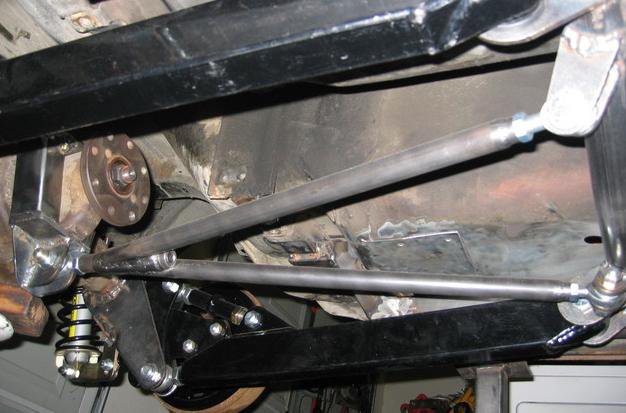

  7. Sorry, this was a one time deal. Desperate guy needed the $$ more than the heads.

  10. Quick update, Fabed up the fuel cell and battery mounting area. Also finished the track rod install which completes the rear end. Also the motor is back out and going the the machine shop on Monday. Front cross member has been notched for oil pan clearance and the front suspension is torn down for clean up. Next comes the TC rod relocation, pretty simple setup. We are using short swagged tubes with rod ends in one end. We cut the original TC rods down and threaded them to run inside the tubes. Also picked up some pre fabed Moroso "u" brackets to weld to the frame in place of the original TC buckets. Got one side mocked up and tacked in place, gonna make the other side now and then finish boxing it all in with plate. Here are a few photos of our progress.
