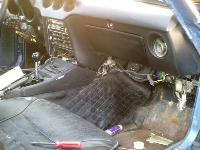

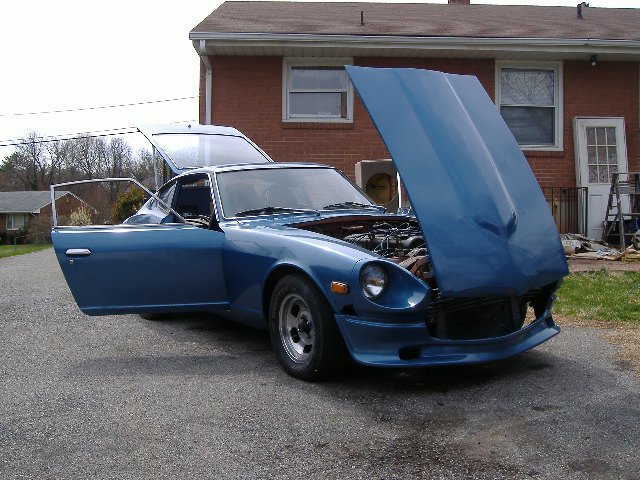

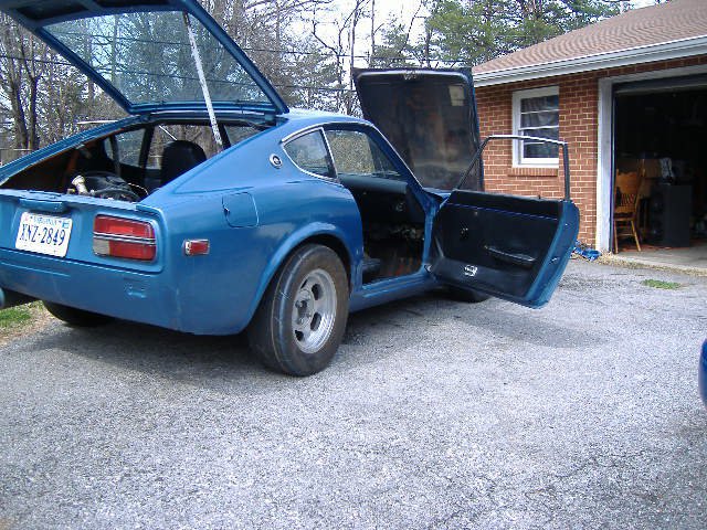

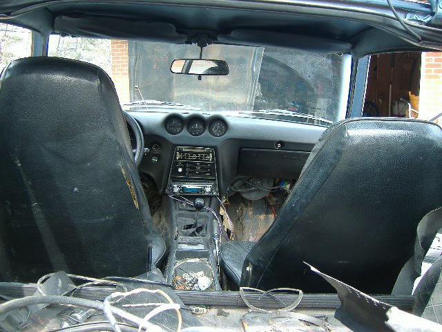

So here she is. I paid 1400 bucks for it. Plus $500 to paint it, unfortunately I wasted my time and money with that. I gotta take the guy to court to get some of my money back. Anyways its a 1973 240z with an l28et and 4 speed swap already done and wired. I dont know what size turbo is on it, I was thinking stock but its rediculously fast.I couldnt get it to go into gear and dont have a license so I was going to sell it for $1500. SO GLAD I DIDNT.I replaced a clutch hose and the slave cylinder, both only $30. The blow off valve was an HKS knockoff and toasted causing it to surge like crazy hitting 2nd. Also it was causing the boost gauge to create 10 psi vaccum. So I ordered a TurboXS H-RFL bov, supposed to be loud. Also I got an MSD HVC nascar ignition box supposed to be twice as good as a 6al. Also I got an MSD HVC coil, and 8.8mm Accel plug wires, NGK plugs. Its got a fuel pump out of a 98 Mustang and a homemade fuel cell wired to a switch. I also just bought a fiberglass hood, hinges, glass fenders, hatch, shock. I gotta go take them off tomorrow.
