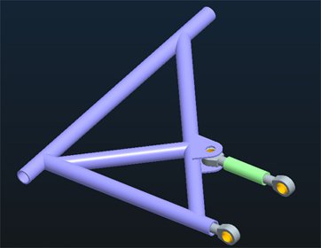

  7. On to Phase 2: Okay... At first pass I'm not liking the forward toe link too much. The basic problem is the toe link really gets in the way of the sway bar link. I haven't figured out a good way to make that work yet other than ditch the sway bar or put the toe link at a bad angle. I did two iterations of this design. The simplest is shown below as LCA2-B (purple). It works the best of the forward link designs and mounts in the stock inner locations. It might be advisable to add one more bar from the inner bar to the toelink joint... but again no swaybar I tried another version using heims on the inner mount (LCA2)(gray), but it really didn't work. There was not enough room to fit two 5/8" heims end to end for the toe link. I do kind of like the inner mount concept though.... see the exploded view. This would use 3/4" bolts and heims with a section of tap tube tying it all together front to rear. I would have to make some aluminum bushings to support the bolts in the stock mount locations. Next I looked at moving the toe link to the rear (LCA3)(yellow). I know this has some drawbacks based on our discussions, but it sure does work better from a design simplicity standpoint. It also lets me use the inner heim design from above. I need to evaluate just how big the drawbacks are to having the front outer mount fixed. It might be a little more tedious on the alignment rack, but probably not by much. I've already thought of adding spherical bearings on the inner bushings and using a fixed tube on the innner mount rather than the heims and that hasn't been ruled out, but it would be about 2X the cost. Go ahead... tell me what you don't like! I can take it. Tom
  8. Okay... trying to get caught up here and my brain is really starting to hurt. So, if I am understanding Dan's sketches and and the output of his spreadsheet, it says that if you have a 1 degree angle between the inner and outer control arm axis the amount of bind that will induce is about .025"... That would be 1 degree of toe per side.... that's a LOT... The most I would ever try and run in the rear is about 1/8" per side, that would be about .3 degrees ( I would really only run about half of that). Using that number in the spreadsheet it says that the induced bind is only about .007" and it only varies by .0015" through 20 degrees of travel. If you loosen your camber plates the .007 will probably self adjust. Chances are the amount of bind we are discussing is way down in noise level or at least well within teh tolerance range. Unless of course your frame is way out of square and you are trying to use the adjustability to compensate... I think I am on board for trying to build something like the arms Jon sketched... the rear suspension is already disassembled for a shock rebuild and the plan was already to build new LCAs. I'll be busting out the CAD soon with an intial design... stay tuned. Tom

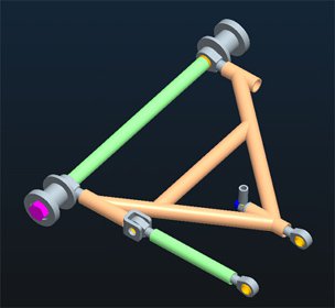

  9. I've definitely seen Johns control arms... My only gripe is there is no provision for toe adjustment. I think I am leaning more towards something like the Arizona steel tube arms with it's adjuster but add heims on the inner mounts... Tom
  10. You finally made sense to me on you last reply Jon... Good point, but I think the thing that has probably convinced me to ditch the plan is the fact that the forward joint (blue) is only held by 3 rotataing points. In other words, that forward triangle is not a triangle. It's a quadrangle with a short leg running through the blue piece. The only thing that will keep that joint from rotating fore and aft is the friction of the clevis bolts. It might be sufficient to do the job, but when it slips it's going to get real weird real fast. Maybe there is a reason that the car I saw this on is a perennial back marker! Time to go back to the drawing board for a more conventional design. Thanks for the reality check guys! Tom
  11. Like just about everyone else, I have an overwhelming compulsion to design and build my own rear control arms. My application is for an autocross only car, so keep that in mind as you pass judgement. It will never see the open road or >100mph... That said, this is pretty much a direct copy of a setup I have seen on a GT2 Z and it hasn't fallen to the ground yet after several years of competition. Only the sway bar link has been added. I really like the total on-car adjuastability. One of my main goals is to facilitate as much track width/camber adjustment as possible from the bottom. Simply detach one end of the mid link and all heims can be adjusted. Toe can be controlled with just the rear adjuster. The inner mounts will probably be a simple bolt-in frame that will locate the inner heims as close to their stock locations as possible. I will update as that get's developed? Does anyone see any major concerns with this? It seems to be a proven design, but I could be wrong...

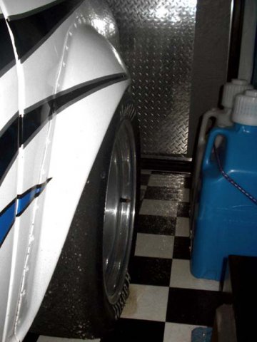

  15. Jon, I'll second what Pete says and recommend waiting until you are on the ground to make your final decision... That said, I have the 3" flares and I am running 16x10" wheels with 5" back space and have run the bigger 23.5x11.5x16 Hoosier slicks with no problems. I had about 1/4" clearance between the tire and the springs, and after running numerous events I did find a small black smudge on one rear spring from a minor rub. I couldn't find a mark on the tire, so it was a very minor kiss or two during extreme conditions (like when I would get on 2 wheels at mid turn over a nasty bump). I never saw any sign that the tires touched the flares, however my flares have a bit of extra clearance ground into them at about 2 o'clock (on the right side, 10 o'clock on the left side) as you face the wheel. The fit of the tires in the fenders looked great, very full muscular look... I've attached a couple of pics that show how it fit with those big tires. You don't say what size wheels you are going to. Pete mentioned 10" wide... If you are planning on 15" wheels, you may need to keep your section width smaller than the Hoosiers I mentioned, to maintain clearance from the spring. If you go with 16's I don't think you can fit anymore rubber under the car than those Hoosiers. If you go bigger in diameter on the wheel, you may be able to get away with a little more sidewall buldge on the inside, but you might have to give up a little overall width on the outside to avoid the flare. Hope that helps a little! Tom
