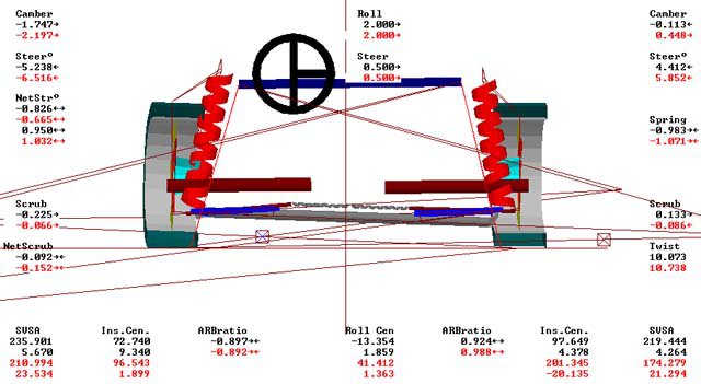

Thanks for the feedback guys! I can't believe I never realized how much info was on this forum... I've had a login here for years, I must have posted more than once before. Allright... so I think adding caster is a given. I will just have to sneak up on that to find the right amount. I am currently running bias ply slicks but I may try switching to the Hoosier radial slicks. That might play into how much I want. Looking at the difference in camber gain I may want to start low with the bias tires and add more if I want to try the radials. Jon, on the rollcenter and stiff springs comment, I am currently on 400 lb springs all around. If I pull the RC up above ground, is that going to drive a change to softer springs? I've got this nagging fear that if I "improve" the suspension too much I won't be able to drive it. I've had pretty good luck with the less than ideal setup, for a long time. I'm not sure I can adapt at this point! Tom -

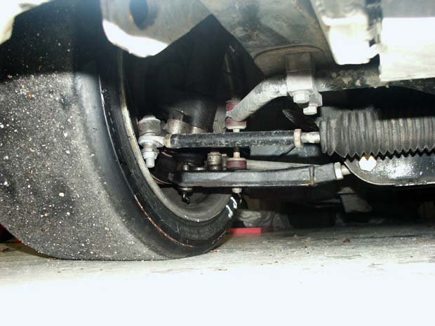

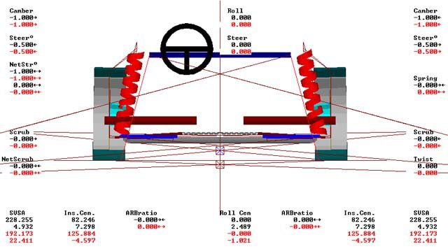

I've been reading all of the very good (and some very long) threads on suspension mods and was curious if there was any firm concensus on optimizing the suspension mounting points on a dedicated race car? Many of you are familiar with my car ( http://sth2.com/Z-car/ ), if not, it is a purpose built F Prepared 280Z autocross car and about the only area where the car is not fully optimized is in the suspension geometry. That is my project for this winter. I started by using some suspension analysis software and took my best shot at measuring the current setup. I think I did a pretty accurate job, using level setup stands, laser levels and virtually every measurment tool in my garage. The results were well below ideal. My front roll center is about 1" underground and jumps around laterally about 4 feet either direction when I induce about 2 degrees of roll. The camber change is going a good way into positive with that much roll. The rear is not as bad with the stock control arms, the RC is about 3.3" above ground and only moves a about 7.5" from side to side in roll... So my main questions are: 1) Is there concensus on where the pickup points should be on a very much lowered car? Front and Rear... 2) I've read the threads on TC rods, but didn't get a solid feel for the benefit of moving those points. I played with those points in my suspension software but didn't see things change much. What am I missing there? 3) Is there a downside to increasing the length of the control arms? Provided I have clearance, I don't see a negative. Is there an area I need to pay attention to to avoid binding? 4) Caster. I've never had much, mainly because I have never made any modifications to make it more adjustable. Currently I only have about 1.25 degrees. I willing to take the plunge and try this stuff, i hear it can work wonders on turn in! Any recommendations on how much I want? That's "all" I can think of right now, but I am sure I will think of more as we go! Thanks for any help. Tom
