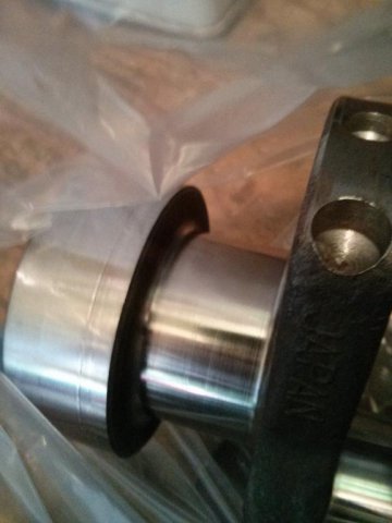

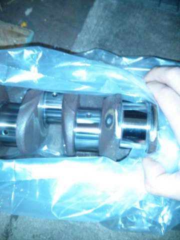

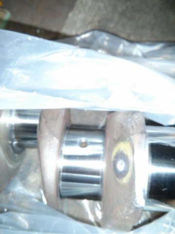

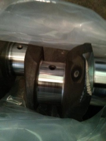

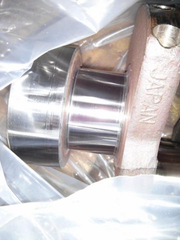

Just seems like he should have taken it undersize so clearances would be perfect and the surface would be as well. If you guys think its OK though that's good enough for me.
I just got my crank back from the machinist - this is the first time I've used this guy and I only did because no one else in the area was able to polish such a long crank. I need you guys to look at these pics and tell me if he did it wrong. I think he just threw it in the wash I can see lines on all the journals... The larger wear line on the back that rides the rear main seal doesn't really bother me I can understand why he wouldn't polish that down. The lines on the rod and main journals do bother me. What do you guys think? Is this going to cause problems? I can't feel these lines but I can see them...
