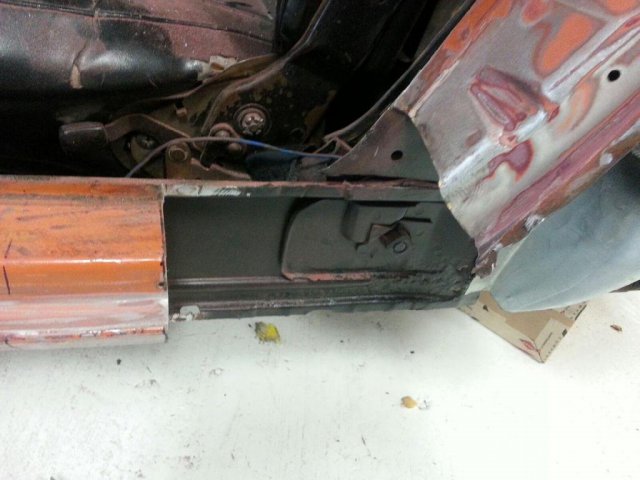

  11. The section between the tape that is cut out. It is right below the door hinge. I had to cut the piece out to replace the rocker panel and when we cut them out, we found lots of mud and patch work.

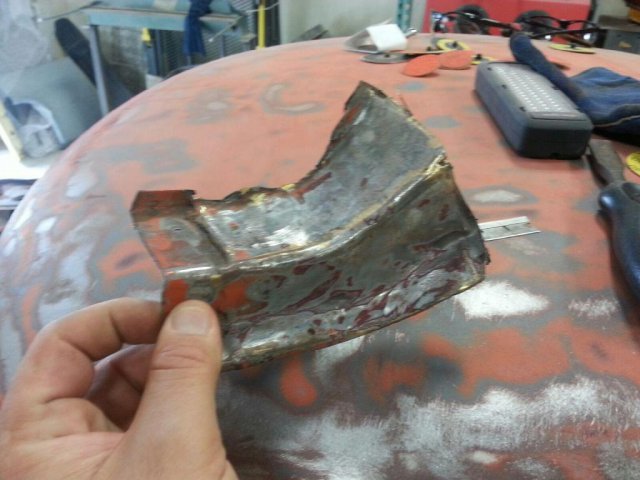

  12. I am in need of the door sil corner bends. I had to cut the ones out of my car and found both sides to be in pretty bad shape. I would like to put some rust free ones. Here is a pic of what I need, let me know if you have something. Thanks!
