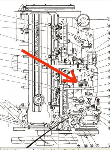

first picture is line drawing of air regulator. Second picture is line drawing of engine from above with big red line pointing at air regulator This picture is of oddmanout84's engine compartment (hope he doesn't mind) showing hose leading to regulator (click the pictures to make them bigger) Aux. air regulator feeds additional air into the intake when the engine is cold to raise the idle. Read up in the FI bible on how it works but, it has a big hose leading to it and coming out the back of it. If the hose is cracked, air could be sucked into the intake. Same with the hose running to the brake booster. One end connects to the brake booster, the other to the intake manifold (on top near the back) with a one way valve mounted on the firewall halfway down the hose. Most likely at the gasket surface between the intake manifold and the cylinder head. This would be more likely if the manifolds had ever been off but could be from manifold warpage. Hard to discover, some guys spray carb cleaner on the area while the car is running, but be careful if you do so as not to catch yourself on fire! Keep trying. Remove the clamps completely. Then peel the edge up slowly all the way around. If they are the original ones they are most likely cracked. Once it's off, spread the pleats and look down inside there. BRAVO!!! Nope... very simaliar problems, good thread title good luck!!!
OK... for the original poster (norstar)... you will help us diagnois your problem much easier if you post the year / model car with your question. Also for something like this, whether it is stock carb / fuel injection and if not, what mods. I'm going to guess you are talking about the car in your signature, 74 260z. If so it is a carb car. Since you stated that you've replaced all the vacumn lines, 100dollarz's suggestion that it's a carb problem may be a good place to start. Perhaps a warped throttle plate or bad gasket leaking air until it warms up and seals itself. Also maybe leaky intake manifold gasket. The sucking sound could be bad vacumn booster if you have power brakes or the line that runs to it. Just throwing stuff out there. fisheric: thanks for posting year / model. I'm not super familiar with the zxt's FI but it is similiar to my 77. You also state that you replaced all the vacumn lines. Have you checked the big one that runs to the air regulator? This sort of makes sense because the problem occurs when cold. The air regulator helps during warm up to slightly raise the idle speed when the engine is cold. Check Dareon's sticky for the fuel injection bible at the top of this forum. Download it and read for more info on how the air regulator works and how to diagnois. You stated that this past summer you replaced all the vac lines and it cured it but came back. Could be that during the summer, when warmer, the air regulator wasn't needed and the problem was masked. Even if the big fat line that runs to it looks good, remove and inspect. Sometimes a line can look decent, but if you look close at it, bend it this way and that, it will crumble in your hand. The line to the brake booster could be a similiar issue. Slight crack, seals up when warm. Leaky intake could be your issue as well. Check the boots between air cleaner and AFM and AFM and throttle body. Again, pull them off, spread the pleats and look in there. Post up results, even if you cure it, so to help others.
