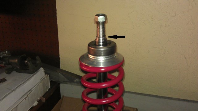

  10. I've just about completed the strut sectioning/coilover conversion in my 75 280z. I just drilled out the D shaped hole in the front insulators so that the top of the Toyota MR2 strut will fit through the hole. I drilled the hole big enough to clear the first little ledge after the threads, but it seems to be resting on the second ledge (one with the arrow pointing to it) which makes it so the bearing isnt sitting all the way up inside the insulator. This seems like a problem. My first thought was to make a spacer for under the bearing so that the bearing would be placed in the correct position. Thought I would check on here first to see if anyone else has a better idea. Thanks for your time guys
