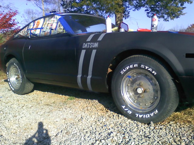

i am currently getting the parts for the 5 lug swap.
( all donor parts are coming from a 85)
for the rear,
i dont currently have any parts for the rear
i will be getting the hubs w/rotors and bearing, cv joints, and the later 280zx's lower control arms BECAUSE ive read with the lower control arms from the later s130, the 300 calipers and everything else is a bolt on swap.
for the front,
i HAVE only the hubs w/rotors and bearings
it LOOKS like the 300 calipers could possibly fit? the only differance i saw was that the calipers are on the front of the assembly instead of the rear like on the 280, so could they work jus being mounted upside down basically...
if those calipers are not compatible, i have read plenty of forums and have gotten a couple possibilities but am still not sure. so any suggestions would be great im open to anything preferably the least fabrication necessary.
