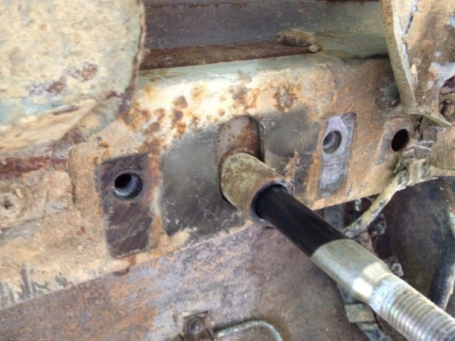

I'm doing the opposite of what most people do. I have a whining r200 and a spare r180 so the 180 is going in the car. It's a 79. I'm having a hard time with the bolt that the diff mounts to. The diff needs to slide about an inch forward. The mounting bolt looks like it could slide forward but I have no idea how. The photo shows the mounting bolt from the car with the r180.

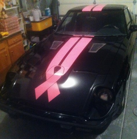

Back from the painter. Remember this is my daughter's ca. The ribbon is for her Aunt who is fighting cancer.
Back from the painter. Remember this is my daughter's car
