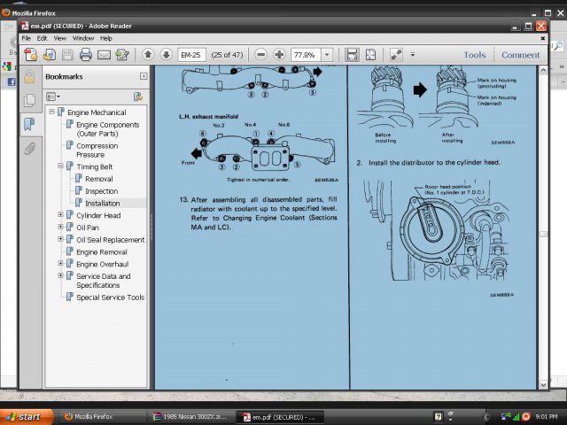

You're not suppose to point the rotor at cylinder #1. Look very closing at which way it's pointing. Only other way I could think it's off is if someone messed with the CAS trigger by messing with the disk.
Okay, what you do is set the engine to TDC where cylinder #1 is on it's compression stroke after this you pull the distributor and set it so it's point at the fuel pressure regulator. That should be the correct timing order, unless he missed a tooth or something on timing belt. EDIT: I forgot to mention make sure the cams are also in alignment with the crank.
