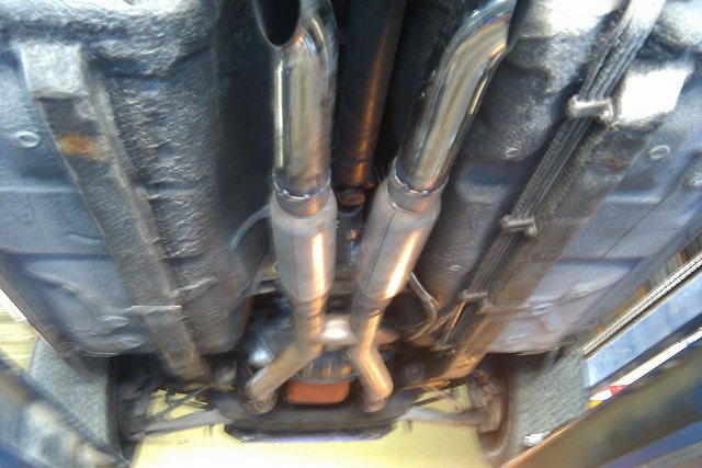

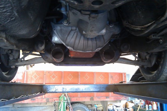

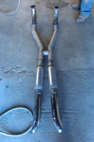

i was just curious how all of you did your exhaust.. here are a few pictures of mine and the setup i came up with. i used an h-pipe from a 99 rc-51 vette(the early z06) and a pair of dynomax bullets. i pieced it together and tack welded it in place on the car and then pulled it down and welded it solid. the oil filter is a little tight but is removeable. i think in the future i will be doing a relocate kit for the filter. it exits right in front of the rear end and sounds beautiful however with the exhaust under the car it is rather loud inside.. as a racecar its bearable but on cruise nights the wife doesnt like it to much. i also added a few shots of the car itself since im new and nobody has actually seen it. tell me what you think and post ur exhaust pics. thanks

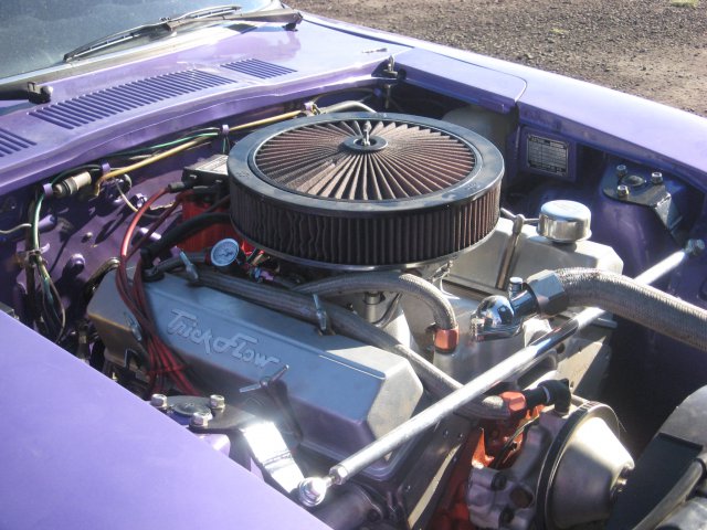

does anybody know were i can find a set of hooker headers part number 2147hkr. they are a long tube header that fit a sbc. or if you guys know of another long tube set????? im currently running a set of shorties and they are very restrictive. i also attached a pic of the engine compartment...
