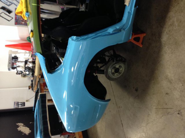

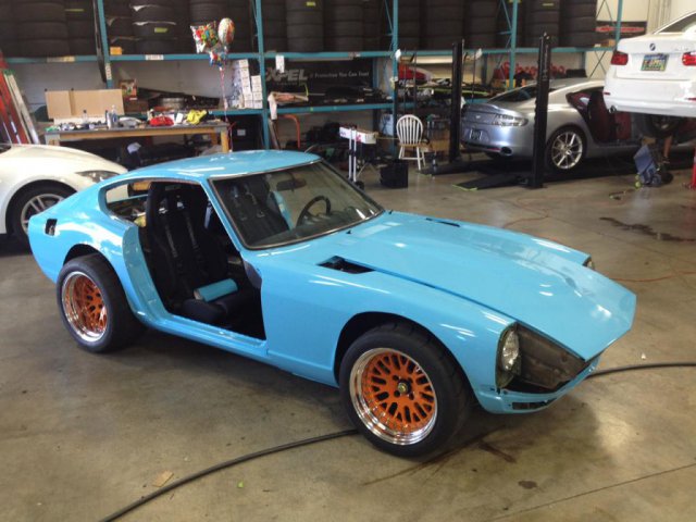

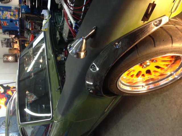

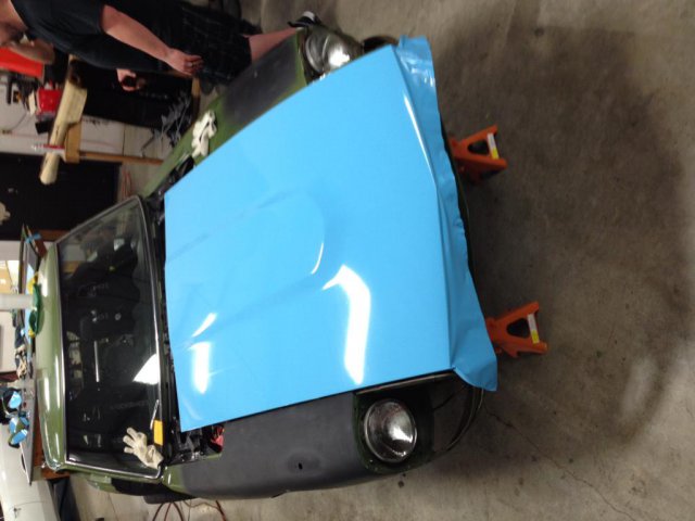

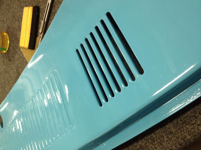

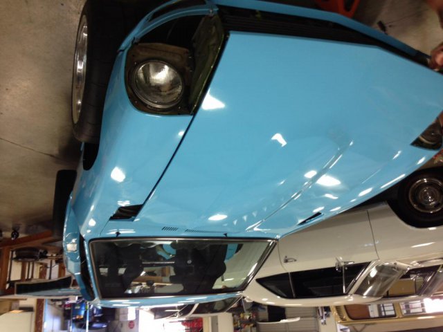

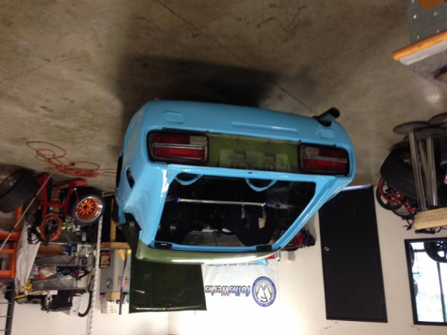

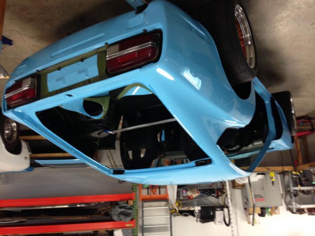

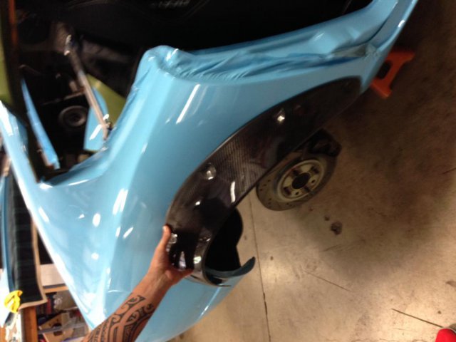

Going to wrap in Gulf Racing Blue. Orange wheel centers and Orange side stripes. Doing a wrap is almost as much work as a paint job, but i do a few HPDE days a year at PIR and a wrap seemed more sensible. Carbon BAMF Flares from jdmflares.com 17x9.5 in front, 17x11 rear NOS fender mirrors will complete the look. You really have to take the car apart if you want to do it right.

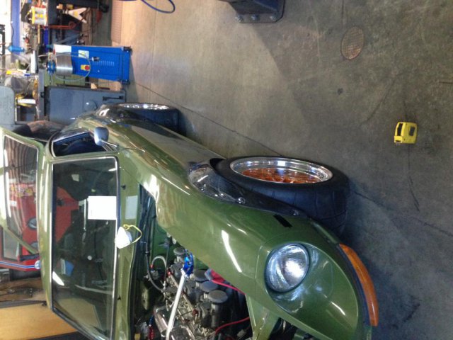

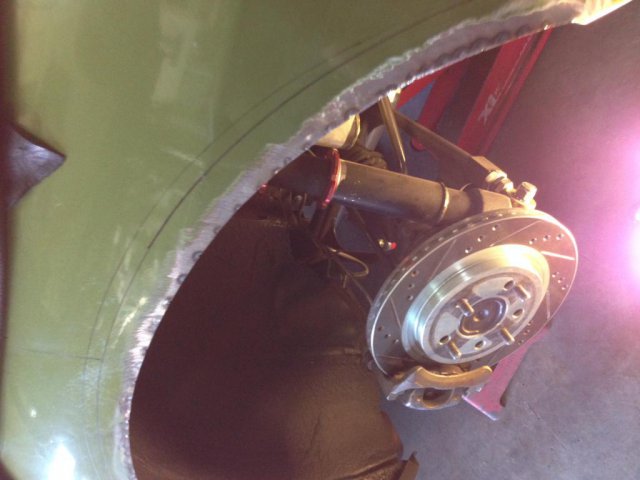

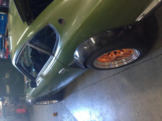

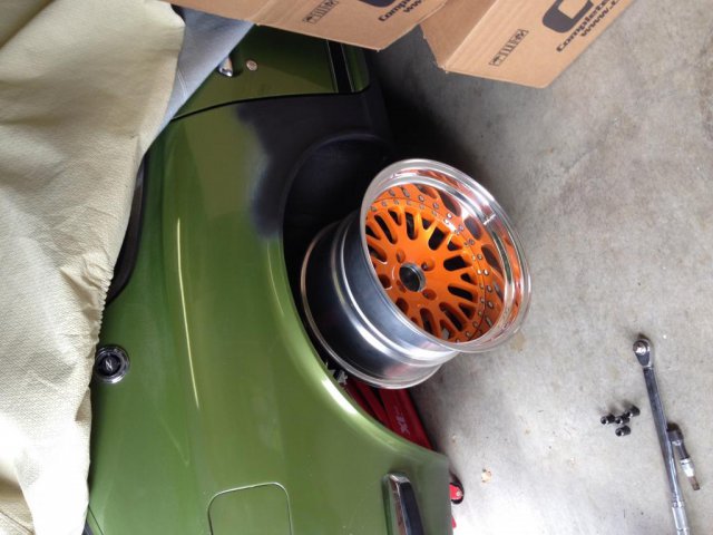

More pics of the progress. Was a big deal to cut the fenders. I was really on the fence about it. But. I have a vision in my mind of what I want the finished project to be.

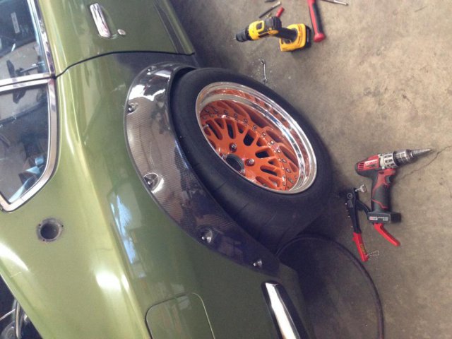

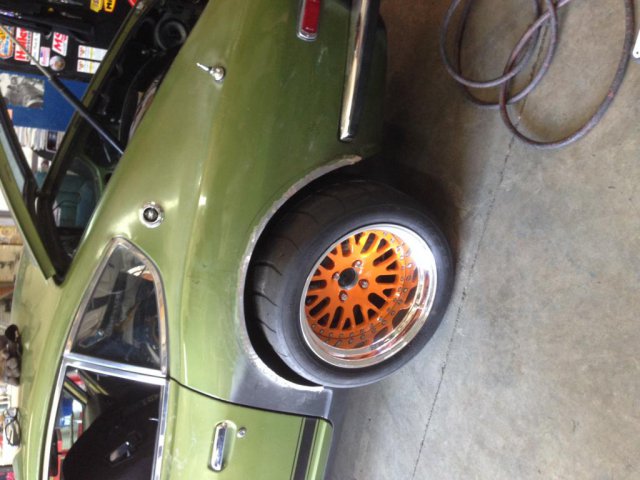

I decided to take my car a step further and bought some CCW wheels and wide ZG flares. I also decided on a new color scheme; Gulf Racing livery. Here are some pics of the progress.

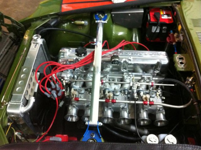

Hey all, a little update, lowered the car a bit and installed Mikuni's that i got from Wolf Creek Racing. Sounds and drives fantastic.

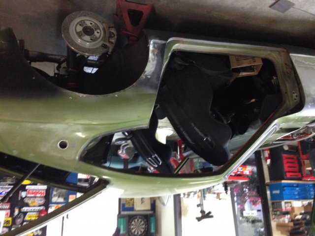

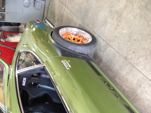

The MSA roll bar fit fine and the quality is good but with these seats, i could not go back far enough and i am only 6 ft. I also could not recline the seats properly. In the end, i simply mounted the belts to the stock location on the body up above the quarter window. Gonna sell the roll bar now.
I ended up yanking the MSA roll bar. Sparco R100 seats fit great but the roll bar would not allow seats to go back far enough or to recline.

I just finished installing the AZ-Car front Wilwood brake kit and the Silvermine Motors rear conversion on my 72 240. I also bought the 280Z 15/16 master cylinder from Edan at Silvermine. I have to say, Edan is a pro and when i had some install questions, he was very helpful. Silvermine's kit is absolutely top-notch. It uses the calipers and rear rotors (re-drilled) from the 2011 Ford GT500 Mustang. The 12" rear rotors are drilled and vented. You have to switch the calipers left to right due to the position of the E-brake assembly but the stock e-brake cables fit right up. You do have to adjust the cables to their max extended adjustment, but then they hook up no problem and work awesome. Because the calipers are switched, it puts the bleeder valve on the bottom, so you have to bleed them off the mounts. You HAVE to put a block or the rotor itself in the caliper when bleeding or the pads will close down to far and you won't be able to get it on the rotor. I made this mistake and the pistons extended and i couldn't figure out how to get them to retract. The trick to retracting these late model Ford calipers is the pistons have to be rotated clockwise while you are applying pressure. It is the only way. AZ-Cars front Wilwood kit is also superb and i went with the 12" vented and the 4 piston calipers. Bolts right on. I opted to forgo a brake proportioning valve for the time being and so far this sucker stops like my sportbike. I have not experienced any rear brake lock-up.

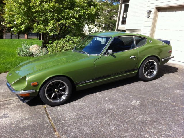

I bought this car last November from my father-in-laws best friend from High School. He was not the original owner but i think the 3rd owner. I got tons of service records and even the original Bill of Sale from the Datsun Dealer in Salem, Oregon. Sold for $4420 new. Built 3/72 HLS30 74950 I did the interior first and POR15'd the floor which was in great shape. The Interior was Butterscotch and in poor condition so i decided to change it to black. Engine Mods (New Motor): 280Z F54 Block with Flattop Pistons E88 Head with new Valve guides/ground seats/seals Stage 2 cam 280ZX Distributor Z-Therapy complete rebuild on the carbs and a shaved balance tube ITG air filters Pertronix Coil MSA 60A internal regulator Alternator MSA 6-1 Ceramic coated header Custom 2 1/4 exhaust Transmission: NOS - 5spd (never in car) Chassis Mods: TTT complete all 4 corners Arizona Z-Car Complete Coilover kit (250lb Springs)(Custom non-adjustable spherical ball upper mounts) Wilwood Arizona Z-Car 4-piston Front Brakes AZC billet mustache bar and billet brace kit Silverline Motors - Rear disc conversion (very nice kit and awesome e-brake) ST ft & rr swaybars (1" ft - 3/4" rr) Rota RB - 16x8 -4 Dunlop Direzza Star Spec - 225/50
