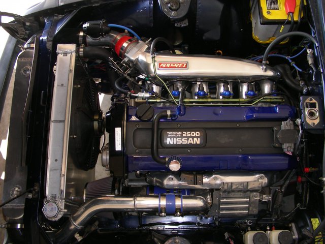

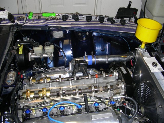

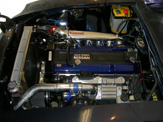

Bought the engine in '00, but finally got it done last month , just in time for the '08 Z-Convention. Sooo nice to get it back on the road. I've owned the car for almost 20 years, and put over 160k on it (the last 100k with the stock L series turbocharged). Right now it's a totally stock RB25DET except for the (real) Greddy intake, 4" thick chinabay intercooler, and bit of powdercoating and polishing. Ck out how clean the cams and the head are. This is a stock USED engine. I really lucked out on this one. A little more boost, and then it's time to start on the body. Don't know if I will have the time or $$ to finish the RB30DET by next summer, but I'm going to give it a try.

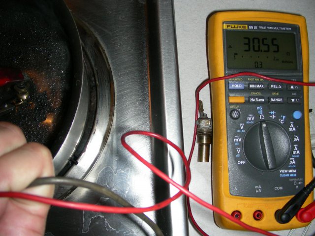

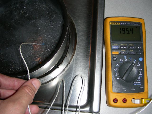

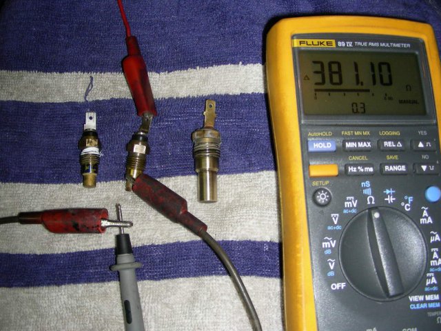

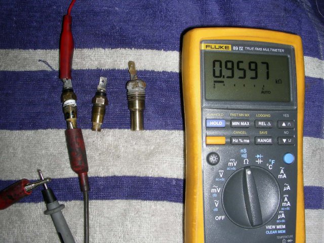

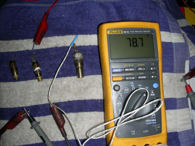

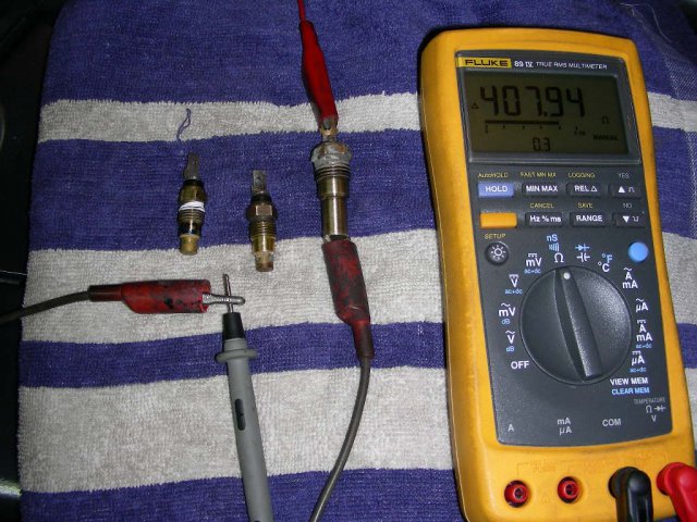

Sorry for the delay, but finally got the pic's downloaded - couldn't find my damn interface cable. I have a pretty decent Fluke multimeter, so I took some temp and resistance readings at ambient, and then heated them up what would be approx operating temp,. The first pic is at ambient temp 78.7 deg F. Second pic is the KA sensor, which was around 381 ohms. Third pic is the L28 which was 407 ohms, so a little split, but not bad. Except for working out the linearity, really not to concerned about the 'cold' readings being a little off. Fourth pic is the RB sensor, at about 0.9597K, so it was waay out there. Then we heated things up a bit. Fifth pic - Got a pot of water going on the stove, and let it stabilize for about 10 min at about 195 deg F. I wanted to get a reading on the hot side of operating temp, because that is where I want the most accuracy. Sixth pic - Keeping the probes out of the water, the KA sensor was pretty consistent around 30 ohms +- 1.5 ohms. Didn't have enough hands to hold the probes and take a pic, but the L28 sensor was about 31 +- 1.5 ohms. So I would say that it's close enough for me. I would eventually like to run it from ambient to around 240 deg, and record every 5 or 10 deg, just to see what the whole range would be, but that's for another time - too many other things I need to get done on the car. Had the car out at the 1/4 mile drag strip last week, and again, temp was dead stable, and never moved off of it's spot just below half scale. (FWIW I ran 13.4 at 105.8 with crappy tires and guessing when to shift - no working tach yet... at only 7 lbs of boost. Put the hurt on a supercharged Cobra mustang ). -

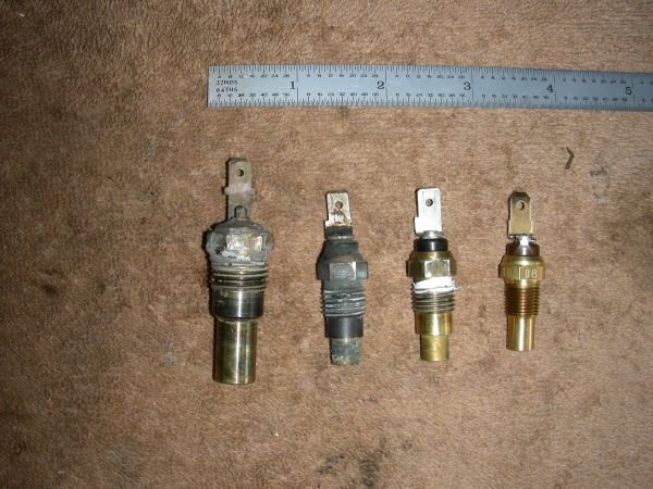

Just got my RB25 in and running a couple of weeks ago. Ran into the same thing with the temp sensor, but wanted a more elegant solution than adding an aftermarket temp gauge or inline sensor. I usually have multiple projects going on at once, and for the first time it worked to to be a benefit. Knowing that Nissan crosses over many parts, I scoured the garage for a similar sensor. By pure luck, it didn't take long - I had a '91 240SX KA24DE on an eng stand, and sure enough the sensor matched size and style. Taking a multi-meter to it, it had the same resistance at ambient temp and the orig Z sensor. Lacking time, I went ahead and tried it out. Just as I hoped, it read just left of center on the stock Z gauge with the eng at operating temp. It even ran midway right of center one time when I forgot to hook up the electric radiator fan. The toyota one from Chris R's install article (LOTS of good info there) was too small in diameter and wrong thread pitch. Hope this helps. In the pic below starting from the left: Stock '77 280Z, '91 KA24DE, stock RB25DET, Toyota one -
