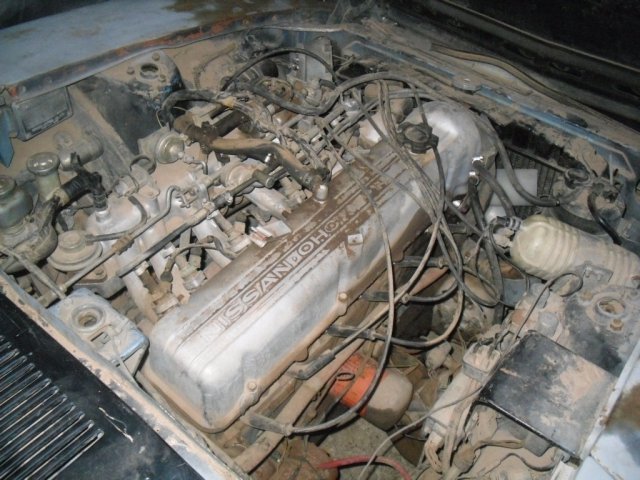

I changed every thing over, and I looked at the two ECU's they do have different pins. I think ive narrowed down the problem alittle, I have power to both terminals on the injectors, I thought I read somewhere that this is right, but the FSM is telling me different. I printed out both the 75' and 78' FSM sections regrading the engine fuel, electrical, and other related areas to help. I tried using a 3 Ohm bulb to see if it would flash, but it does not. The FSM says that this is a control unit failure, Im going to get another ECU asap. NewZed ill try your suggestions and update you once I'm finished.
