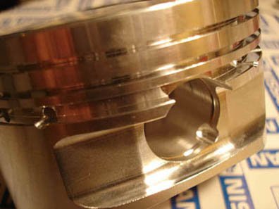

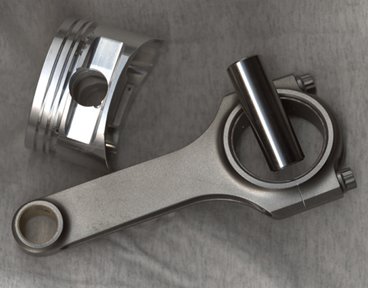

  3. A couple more pix of my JE/Carrilo 5.510 long rod. Phred
  4. Mack, it can be done. You just have to pay the piper. I have been on a similar mind set, and have the hardware in hand. I chose to go with a + .040 overbore on an F54 to maintain cylinder strength. With the LD28 stroke, this combo has 2960.4cc. I have the longest rod I could fit in it, an L16 length of 5.510, made by Carrillo. The pistons are custom JE with a comp. Ht. of 1.056. You'll notice in the pics that the pin is into the oil ring land! This is handled by a thick lower oil ring support rail which is installed after the rod/pin/locks are assembled. Then a std. 3.5mm three piece oil ring is installed, followed by the 1st and 2nd rings which are 1.5mm ea. Datsuns have terrible rod/stroke ratios, and it would have gotten a lot worse if I hadn't gone with this setup. No, this hasn't hit the dyno yet, but I have built other engines with a similar rod/piston/pin layout which were sucsessfull. So I hope my own engine is too. Phred
