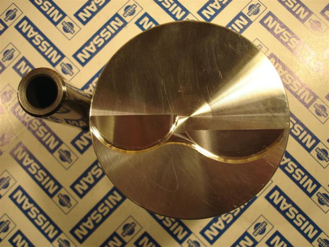

Pics of My JE Forged Pistons & Some F54 Block Prep Pics
Phred replied to slownrusty's topic in Nissan L6 Forum
The valve relief placement does look different. Maybe its just the different depths that create an illusion. The only way to tell if they are in the right location is a simple test. drop a little clay in there and rotate it over to see how much clr. and edge relief you have. I have milled many reliefs in pistons, and set up the valve centerline by a light center punch mark on the piston. When pre-assembling your eng., run the piston up to 10 degrees before TDC. then set the bare head on the block. Take an old valve, and cut the head off, and machine a center point on the remains of the stem. Then just drop it into the guide and lightly tap it. This will leave a mark on the piston at the exact center of the valve at the closest point the valve will come to the piston, usually between 8 and 12 degrees before or after TDC. Also, JE does offer (for a price) a service called 3D lightening. Where they machine the underside of the piston to match the dome, leaving a constant dome thickness. For more comparison, this pic is a set I have that was made with the same forging as Yassin and John's. Its a flattop with deep reliefs for a bigger cam. Phred
