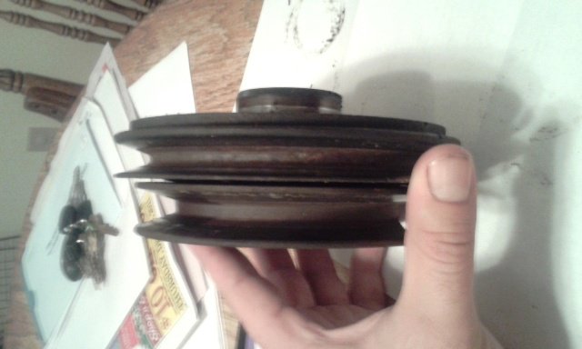

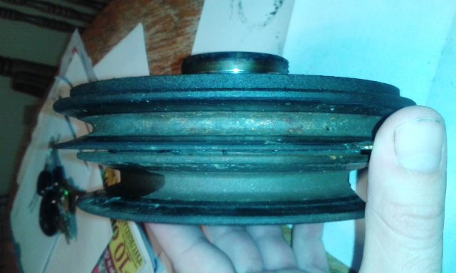

That looks like what I'm looking for! Do you have a side shot of the pulley so I can compare the grooves?

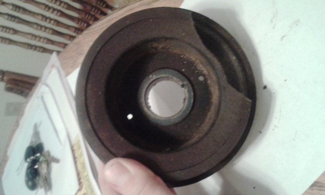

I got a used pullet in the mail but the AC belt will not fit on it, the groove is too narrow. The pulley I have is from a 78 280z, I was not able to take a picture of it this morning but is there anyone that would have a pulley to fit this exact application? Th eone I recieved does fit on the crank snout but the radii are much smaller and the grooves are narrower.

I don't have a pic, I thought the groove spacing was the same though? If the diameter is bigger that's fine I just need something to get me going. I have a 2 vbelt design ('78 280z with AC) but I heard the 3 belt will work and just leave an empty groove (who knows I may upgrade to power steering one day). If I can bolt it on my crank and hang the belts from it I'll take it. I really just need to get this thing going before December 8.

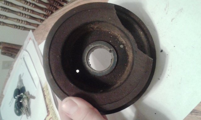

My crank pulley is badly cracked and I need a replacement, is there a good place to get a used one or a cheaper alternative to the $250+ new ones that I see? I'm kind of desperate to get one in the next week or so but I cant afford to pay through the nose. Are their pulleys from other viehicles that can work? The local salvage yard has no 280z's or 280zx's.
