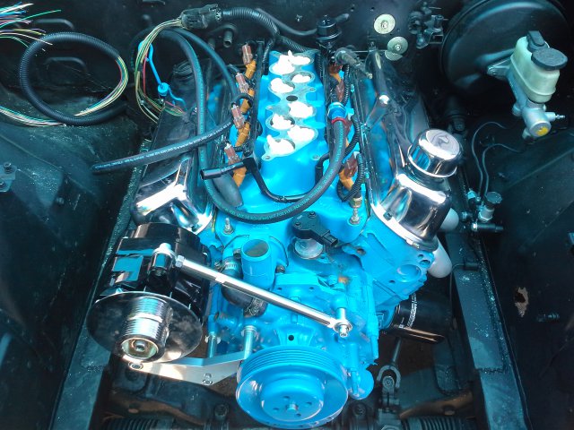

The intake can be mounted either direction. The problem that I encountered is the fuel rails from the explorer....the nice chrome ones with the flow through design...has the regulator on the wrong side. Had to use the town car rail....which isn't nearly as nice. I think the throttle bodies are arranged differently as well, but I'm not sure. I'll dig up pictures as I have a side by side (for size comparison)

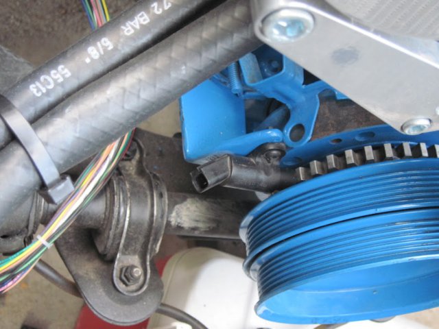

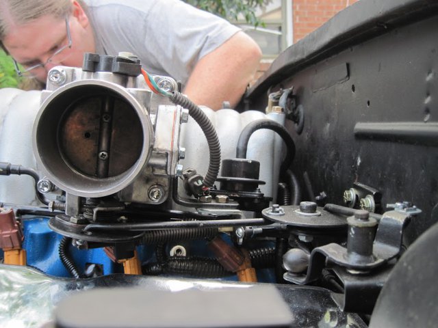

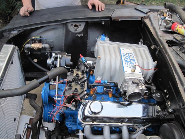

Just a quick udate. Haven't been posting play by play or anything like that since nobody seems interested. Got the upper intake installed. A bracket made for the coils. various sensors mounted. Trigger wheel centered and attached, along with its pickup. got the throttle and trans link figured out. (Made bell cranks. When was the last time you saw one of those?)Put the radiator in. Hopefully my guages will ship this week so I can reinstall the dash this weekend.
Getting closer. Next weekend will be all about the trigger wheel, and hose routing. Which should end with the upper manifold installed, and the beginnings of figuring out throttle and trans.

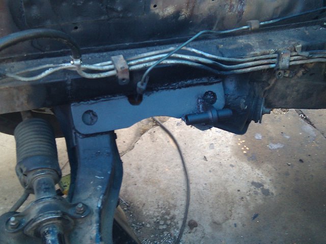

Brake lines held pressure. finished prepping the engine bay. Looks like next weekend I get to install the engine and trans and actually mean it. Slowly but surely.

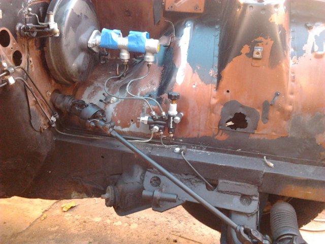

Got the brake lines worked out this weekend. Also did some fiber glassing where the battery box used to be. Need to buy front rotors and hardware before I can pressure it up and see if it explodes or anything. As soon as I'm sure there are no leaks and finish plugging holes/painting. I can begin to put stuff in it for the last time.

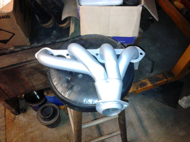

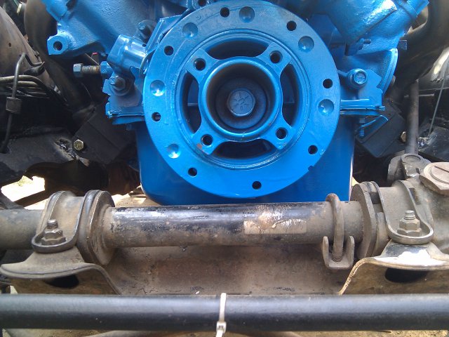

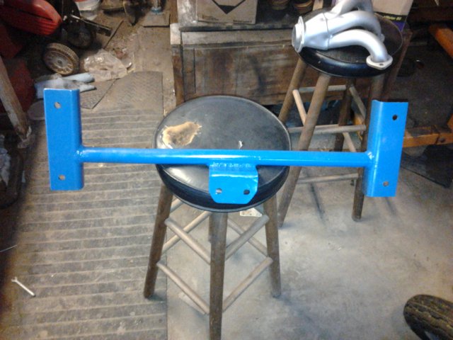

Thought I would go ahead and start a progress thread here. I'm through with mount and crossmember fabrication, and all the test fitting that goes with it. Just about time to start assembling parts. This is a stock 302 out of an 87 Lincoln Town Car. Along with an AOD. Not really bothering with much in the way of engine mods until I get it up and running. Only "performance" parts are the explorer intake, injectors, and the headers. I will be controlling the whole thing with a MSII using an EDIS trigger assembly. Expecting something like 210hp flywheel. Here are some pics of the test fit. Along with the header clearancing and motor mount tack. Here are the finished motor mounts and transmission crossmember. Along with a painted header just for kicks.

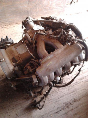

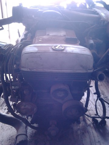

I went looking through the salvage yard down the block and stumbled across this 2J sitting in a storage container. It came out of a 96 SC300 auto. Slapped down $50 to hold it. Going to pay it off in two weeks. $300. Several W58's sitting in the container with it as well. I'm all excited and stuff.
