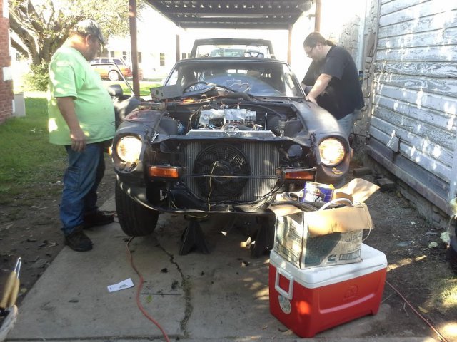

First start. Had an issue with the vac ports we had chosen not being actual vac ports. Still have to plumb signal to the FPR. Pretty close base map though. After I pulled a little fuel out of the map to compensate for the dead FPR it smoothed right out. Time to make an appointment with the muffler shop.

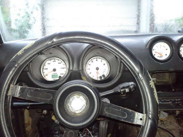

Got the dash back in. All the guage wiring and such is done. Feels like this is taking forever....and the weather has not been on my side the past couple weeks.
Guages finally shipped. Took them two weeks. They will not be here in time to install this weekend....damnit.
