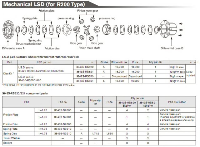

  3. Hello. It has taken some time to source new parts for lsd but I have em now. You can still order friction plates, spring plates, friction disks and whole sets from nismo usa or here http://www.nengun.com/nismo/lsd-repair-parts to R200 or R180. Some of those parts are also listed in nismo catalog.
  4. Hello everyone. I bought used R200 lsd unit and after opened it, discovered that other side was missing all disks and springs. Well as you might quess, these parts are pita to get, especially for a guy living near north pole... Hope some day I found parts to put this together. Be wiser, never buy parts without pictures of all parts icluded..... So incase some one needs to get friction plates made, I desided to share this cad drawing I made to everyone. Download Br Silli Finland
  5. I can get away without friction plates by shimming but those spring disks are essential as I am aware of. Anyone having those for sale ?
  6. I run to dead end trying to find parts for overhauling R200 lsd. Doesn´t make it any easier living in finland. Hope some of you guys can help or point the way to those parts listed below. -2 pcs 38436-N3210 spring disk 1.75mm -2 pcs 38432-N9000 friction plate How it will work if I chim it together without those parts ? There will be then atleast only half of spring pressure to disks ? Any help appreciated, now having most expensive 80 lbs pile of.... without those parts. Regards Silli
