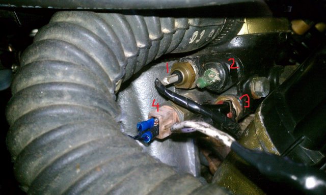

from "http://www.zcar.com/70-83_tech_discussion_forum/where_is_temp_sensor_81_280zx_644149.0.html" The following is for a 79, the location of the sensors may be different for an 81 but the description of what they do is correct Looking at the motor from the front, the thermostat housing has the following items: At 2:00 o'clock the "Water Temperature Sensing Switch". It controls the fan which blows air towards the injectors / intake manifold when the coolant temperature is above 110C. It has a single wire connected to it with a "male" bullet connector at the end of the wire. (it is usually green and about 2" long) At 4:00 o'clock the "Water Temperature Sensor". It is connected to the ECU and provides coolant temperature readings in the form of a change in resistance. As the coolant temperature increases the resistance decreases. This sensor works in conjunction with the "Air Temperature Sensor" in the AFM and is also connected to the ECU. These two sensors provide input to the ECU so that the ECU can change the fuel injector pulse width. At 8:00 o'clock the "Thermotime Switch". It is connected to the "Cold Start Valve". At 10:00 o'clock the "Thermal Transmitter". It is connected to the Temperature Gauge in the Dash. It has a single "male" bullet connector built into the end of the sensor. Wayne Monteath Masham, Quebec. -

Thermo Housing is that of a 280zx -

The temperature gauge in my dash just reads maximum when I turn the ignition on, and whilst I have the engine running... Retracing and repairing the wiring throughout the engine... I found after tracing the wiring harness has a pair of wires snipped and free without a connection, they are both green and were taped with the wires that run to the thermotime switch. Can somebody please identify the components of the thermostat housing in the photo I uploaded? Off the top of my head, 1: ? 2: ? 3: Water temp sensor 4: Thermotime Switch

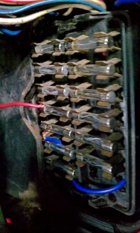

Visibly confirmed spark from each plug, consistent and not erratic. I have cleaned all the pickups and checked out the distributor and freshened up the spark plug wires... The ignition timing must be off, but I have attempted to start with every possible timing setting on the distributor... The fuse box has a splice to the AC fuse, and one to the Fuel Gauge fuse. The center console has switches to power the fan/AC compressor ... And the FUel Gauge works fine... Although these wires could lead somewhere else... worst wiring cluster dance I have ever experienced...
Just tried putting a 5ml shot of oil into each cylinder to up the compression, felt like she had more kick and a soft putter. I adjusted the timing on the distributor just slightly with each attempt and could only flirt with the engine starting. Sounds so close. The injectors are definitely squirting, the plugs were filmed up in gas when I pulled them. Will let her sit for a while tonight while I rip up the rest of the wiring in the interior. I open the AFM and squirt starting fluid in there, to sit between the AFM valve and the throttle chamber and it just ignites and pops back out ... :0 Found two random wires spliced into the fuse box, will follow them back to see what this idiot has wired them to... please see below. (how do I post an image on this forum?) only allows me to add a weblink...
