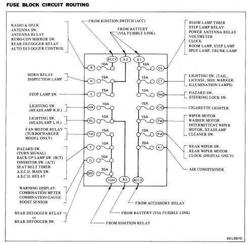

	Someone jacked my radio, and since i've been having problems intalling a new one. The fuse block blew a series of fuses at one point and i had to take the radio fuse and bypass the block and install an in-line fuse. on schematics, the BROWN & RED wire leads directly to the battery lead in the accessory portion of the ignition switch, and still i've got no juice. No multimeter/volmeter/amp-meter to test the power lines. Is there something that i might be missing? can anyone fill in some gaps here that doesn't involve expensive tools.

Everything on the left part of the circuit on *IGN* and *ACC* circuits, that is connected on the left row (not counting the headlights and such) are all shorted out. My warning lights are lit up, i really think i've found my problem. 1 The radio doesnt work, 2 My stop light works but it says that it doesnt on the warning display, 3 My blinkers do not work a'tall 4 and the sound (buzzing) stops when I go into the REVERSE POS. on my M/T . . . I do believe I've found the culprit . . . Now how do I fix this? lol That's where i'm stuck @. -

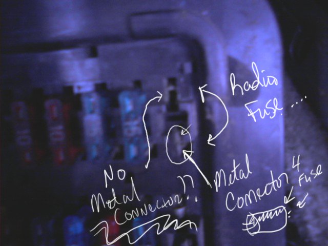

so here is my problem with my radio i am sure. the pictures i tried to be clear; there seems to be a piece missing that connects one side of the fuse to the wiring harness on the block. Its just not there. I circled in the picture. I compared to other fuse slots, and they all have a piece that looks like a rolling-bar/conduit of sorts that triggers the electrical connection when a fuse is inserted from the brown/red wire to the yellow, creating a complete circuit. Maybe this should fix the radio problem My radio doesn't turn on at any position right now And there is weird buzzing, is definately coming from the fuse block itself. . . But i can't see any blue sparking or arcing of any kind, so I can only assume its the terminal that is busted is somehow grounding out. Though, i can't smell anything is burnt either... I unfortunately am broke, and do not have access to a multimeter at the moment or amperage meter so this makes it difficult. Unfortunately, how it looks from carfiche's electrical diagram of the fuse box, i may have blown that entire line out. . . -
