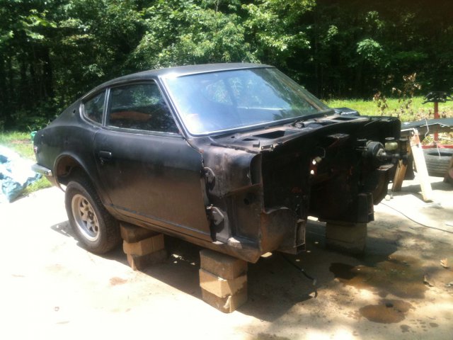

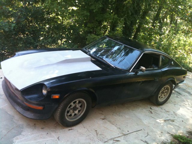

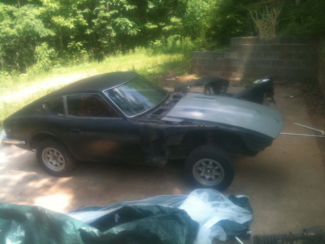

Sense I cut the front clip of the z as one complete unit I am able to use it as a base to build the custom front end. I bolted the hood back on the front, fitted the finders to get the lines as close as I could. The panels are quite flimsy at the lower rocker, so I'm going to weld some bracing to add strength and keep it frommoving around. I'm going to use bondo to to cover all the gaps, block sand the panels to get them as smooth and straight as possible. Then make a fiberglass mold of the complete front end, merging the finders, hood, light buckets and the little hatches on the side of the finder. My idea is to brace the fiberglass front end with metal skeleton, the whole thing will open as one. The plan is tohave the engine bay as bare as possible, once the front clip is opened it will reveal the engine and the front suspension. I'm wanting the wheel wells to open with the front as well so you get the full view of the engine from all angles. My only concern with this is there will be no real core support as the radiator will be bolted to theframe rails and brace bars to hold it in place. This would make a front end colision devastating to the engine. So I may concider adding a tubular bar infront of the radiator to act as a bumper to keep anything from reaching the engine. The drawing I had posted previously is the body style I am trying to create, the only other difference I'm considering is changing the lights to a more modern look. -

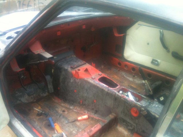

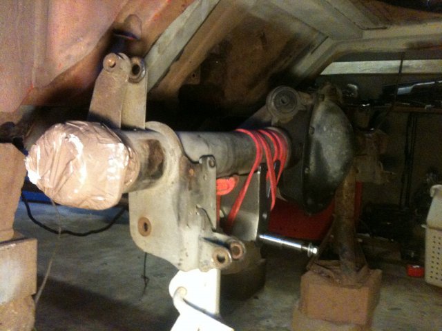

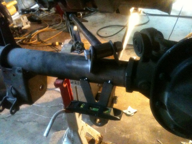

Here are some more pictures of the rear end build. i still have some more welding to do on the frame, then clean everything and seam seal. As of now, im in the process of saving money to build up the 8.8 with disc brakes, axle shafts and gears. I am also cleaning the undercoating off the bottom of the car, a quite tedious task. I appreciate the support, and the interest in my build. -

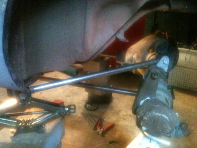

timothyblythe240z replied to timothyblythe240z's topic in S30 Series - 240z, 260z, 280z
At firs for the rear end I wanted to put back and independent setup, but at a price I couldent afford. The alternative was a ford 8.8, I had looked in to several different options for linking the rear end to the body. The best setup I found was a triangulated four link. I did some research on it and wasent able to find much on intergrading it into a 240. I perchased a universal kit and began the process of installing it. After spending some time looking at how I wanted to approche the build I began mapping out the setup. I was able to install the four link with relative ease, only miner fabrication was nessisary. I will be piston pictures of the setup shortly -

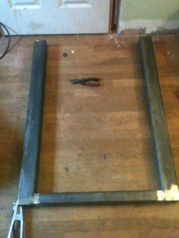

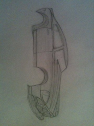

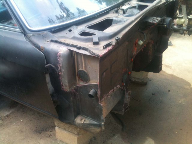

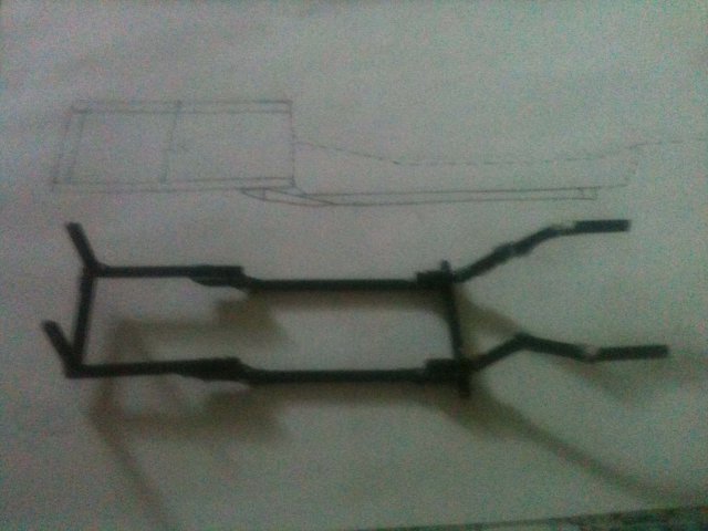

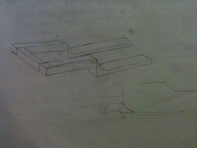

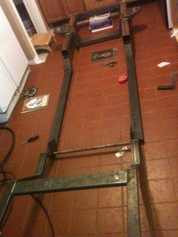

After Doing some homework on the project i realized how much weight i would be adding if i made a full frame for the z, so i went in a little different direction. instead of doing a 1/8 thick frame the full length of the car, i only did the front frame rails as a solid unit. from the floor pans back i reinforced the the body with a tube frame. I began the project by taking some measurements of the frame rails, measured for the center of the wheels so the fenders would line up right when the crossmember is welded on. I drew some prints for the frame and began the precess of saving money for the metal and suspension parts. After taking careful measurements of everything i felt that i would need i cut the front of the body off at the firewall, i then began grinding the old rails back to the firewall. after everything was cleaned up on the front of the car i cut out the old rusted floorpans, and a few other various things i felt were unneeded. AS for the rear of the car i pulled the suspension off, cut the shoctowers down to the wheel well and cut out the spare tire enclosure making room for the fuel cell and 8.8 rear end that will be added later on. At this point the car is completely gutted there is nothing but the body left. after a few weeks of saving i was able to purchase a mustang two IFS, crossmember, metal, and other materials needed to build the frame. I am uploading some pictures of the progress and also some concept drawings -

solid frame, body separate from frame is the idea. I am still considering tube frame, as i am not sure of the correct way to construct a solid frame for this application. -
