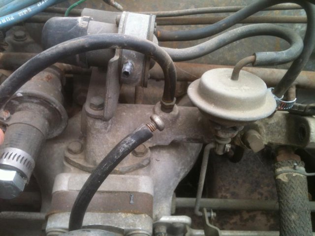

	  '72 240Z Backfiring Through Carbs at Low RPM.Connor280ZX replied to Connor280ZX's topic in Nissan L6 Forum Oh, damn i see what was going on... The lines for that idle motor thing and the dizzy WERE mismatched. I think this is the correct order, thanks guys.

	  '72 240Z Backfiring Through Carbs at Low RPM.Connor280ZX replied to Connor280ZX's topic in Nissan L6 Forum Are you sure that's a vac advance line? Because my vac advance is already hooked up to the intake manifold...

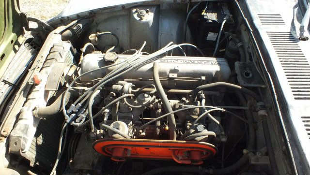

	  '72 240Z Backfiring Through Carbs at Low RPM.Connor280ZX replied to Connor280ZX's topic in Nissan L6 Forum Thanks alot for the tips, guys. I took some oil out of another two sets of SU carbs that came with the car and filled up the carbs that are in the car now. Oh, and timing was at 0 BTDC, now its at 3 BTDC. Problem is completely gone. I can punch it from a crawl no problem now. Thanks again.
	*Typo in title, its actually a '71.* If i give the car more than a touch of gas while driving at low RPM (1000-2000) The engine stumbles and the carbs backfire repediately. I have to slip the clutch higher to get going off of a stop in order to prevent this. It seems to run fine at higher RPM's. Does this when its cold, and when it's warmed up. I don't think its running lean because the plugs are nice and brown. Description of engine: L24/E31 (PO says he installed a Crane Cam years ago, not sure what stage) Twin 3 screw SU Carbs I've just done a small tune-up: -New NGK plugs (.035) Gap -New Dist. Cap and rotor -New fuel filter There is some oil in the carbs, but i'm not sure how to measure how much. There are some strange mickey moused vacuum lines here and there. Let me know what you guys think.
