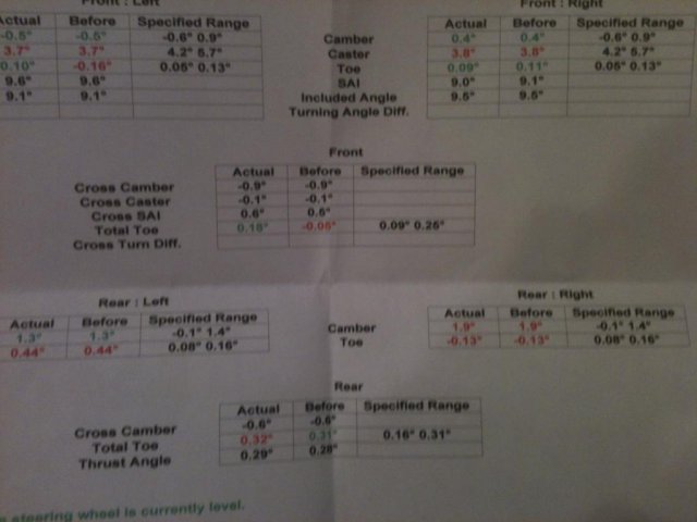

  13. Yeah, and being highlighted in red meaning its out of the reccomended range. I've had a few problems in the left rear area before. I've had a siezed parking brake cable and a bent/warped rotor (was like this when i bought the car). It also had a 215/70 on that wheel when the rest were 205/70's. Looking under the car all the bushings look good. From what i can tell nothing looks bent, though i've been under the rear of my car dozens of times and never noticed anything that looked off.
  14. The wheels seem to be on very tight. No clicks or creaks when shaking them vigorously. Taking another look at the data sheet, these numbers are starting to bother me. Why would you have 0.44 Toe on the rear left, and then -0.13 on the rear right?

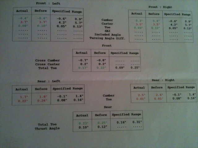

  17. I've gotten my cars wheels aligned three times at the local shop. First time was for replacing steering rack bushings, second time was for replacing the rest of the bushings and this most recent time after replacing the tires. I've gotten it back each time with the car pulling to the right. Holding the wheel rougly 15-20 degrees to the left keeps it straight. Any less, it wanders to the right. I've been using 205/70/R14 tires. Before i bought the car, the ignition switch was replaced. Could someone have put the steering wheel back on the column improperly? Most recent alignment slip attached.
