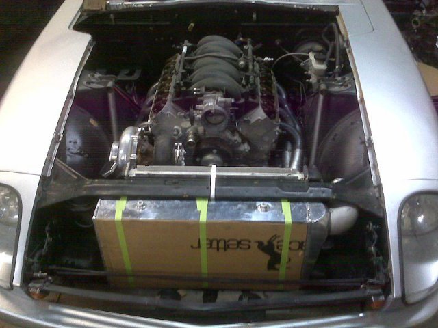

The gauges are all autometer white faced guages (Speedo with odometer,Tach,fuel,volt,water temp,oil,boost,wideband air fuel) The ls1 has a rebuilt 6 speed transmission. The fuel system is a custom 417ms dual walbro 255 setup. The car is tuned on hptuners through chris locally which is the best tuner localy for ls1's. I had the car painted. Carbon fiber hood. Big front mount intercooler. Lots more to say just let me know if you want more info...

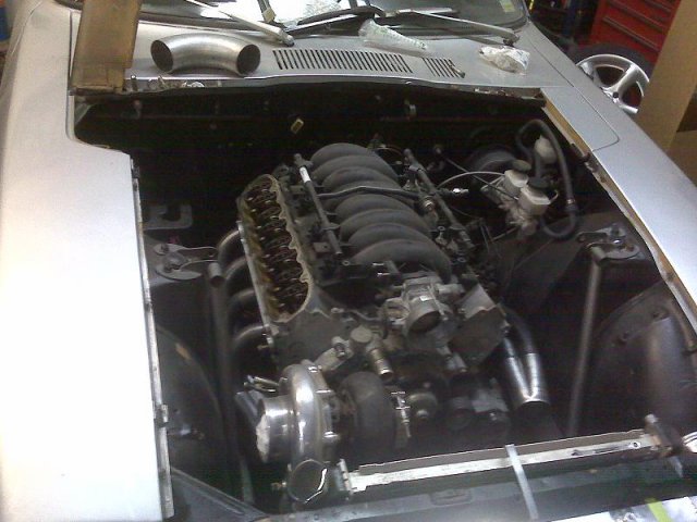

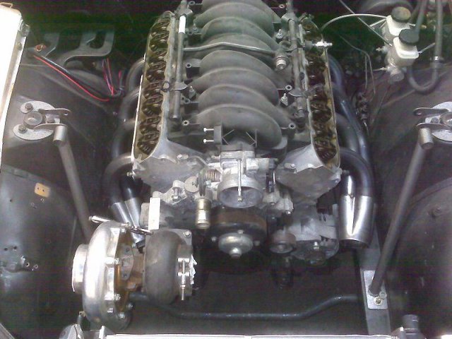

I pulled the motor when I recieved it being im not an sbc fan. Ordered modern-motorsports billet 280z stub axles and billet cv adapters . I changed the half shafts to the 280z cv axles and had them cryo treated. To complete the rear end I had 417 motorsports a local shop custom make a rear mustache bar and diff mount. 417 motorsports also did my ls1 install a custom set of motor mounts. They then installed a custom single t72 ball bearing turbo with fully coated custom turbo manifolds. They are completed with full stainless 3.5 inch exhaust with electric qtp cutout. I had original 280z seats completly remade from frame up and installed new carpet and rear quarter interior panels.
