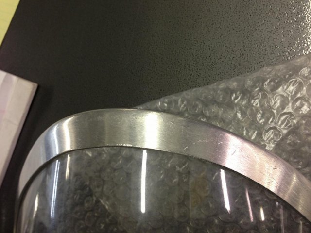

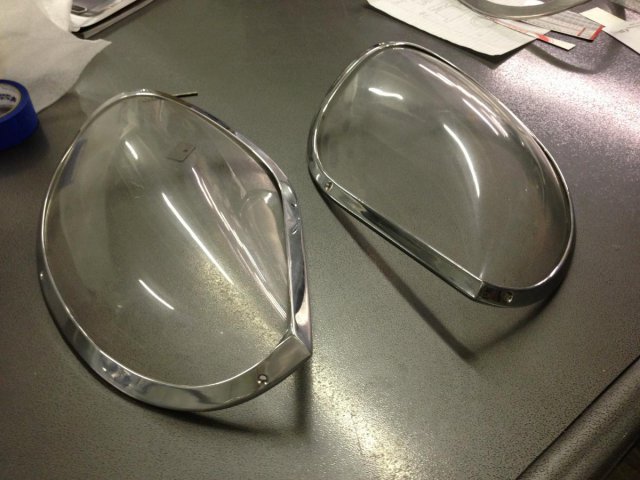

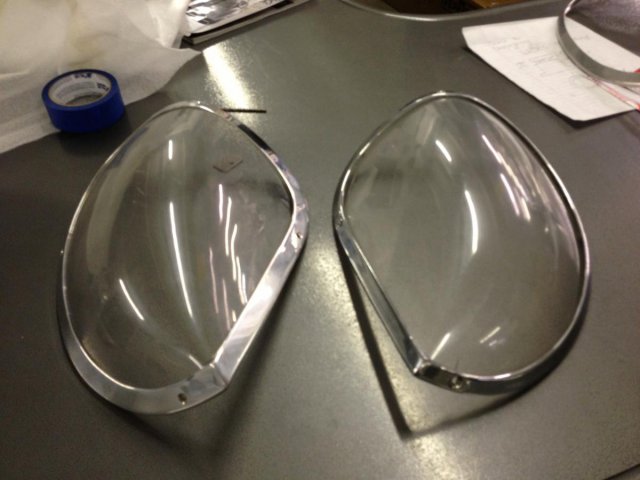

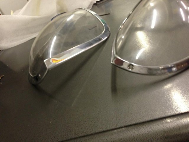

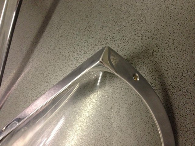

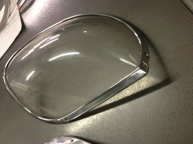

  7. To All: The pictures speak for themselves. The trim ring version you see here lays flat against the glass/plastic lens. On the oem trim ring the holes for the screws were pressed through and the depth of the turned down portion on the underside for the screw holes was the depth of the turned down lip that ran the length of the top and bottom edge of the oem trim ring. I suspect the oem rings were designed with the turned lip be ause they were pressed and made of cheaper thinner material that was chromed. . On the polished aluminum trim ring the screw holes are counter sunk into the face of the trim ring which allows for a very snug fit to the plastic lenses. Thats said, Since I've committed to having an oem match made I'm going to have the buck made for that oem trim match but I must tell you quite frankly next to the polished aluminum trim rings depicted the oem band (chromed) looks cheap and like something you'd pull off a Volkswagen. The oem trim ring really looks cheap as compared to the polished aluminum trim rings. Even with the buck, there is quite a bit of hand work including polishing so the fabricator is asking for 175.00 each trim ring plus shipping (shipping shouldn't be much) so 350/set. We anticipate the lenses will not add substantially to that cost. Take a look at the pics and share your thoughts. I may be able to get a discount for a run of 25 or more...I've attached side by side pictures with the oem trim ring to the right and the polished to the left. As with anything, the advances in technology allow for such an improvement I can't imagine anyone would want an oem replica but we will offer them...
  8. I agree and there will be two versions for each headlight trim ring cover type. One OEM match with two tucked ridges and the non oem with one tucked ridge. By tucked ridge or lip I mean the upper and lower edge of the OEM trim ring that turned down. By flush against the headlight lens cover I mean the edge that would have turned down on the plastic lens on laying on the outside of the lens. I will take pics and have arrowws point to both......To go completely for an OEM look you would have to chrome the aluminum rings, I can get them chromed for those that really want that done but I personally am not a fan of chrome anything.
  9. I just noticed that by reproduction lenses it appears you meant the ones currently offered through motorsports and the like? Is that correct? If that's what you meant I am confident these wont fit. The original lens covers went over the headlight bucket and the ones sold today via motorsports As depicted in your picture are snug to the edge of the headlight bucket cut out (originals sit over top of that edge yours are flush with). You'll need the new lenses and trim rings.
  10. There will be oem versions with two trim ring options for the oem and aftermarket set (if we get an aftermarket donor set).
  11. Not yet but this isn't a business model for me. I had access to the resources and could get it done one off but the set for continued prodiction wasn't that much more from the one off, well, relatively speaking. I'll have the cost of the trim rings by next week when I get the polished set. And, ill keep updating with regard to the buck for the plastic lenses and associated costs.

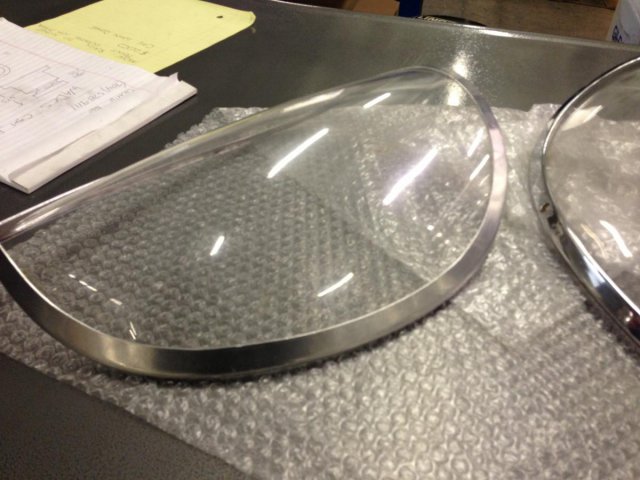

  13. I'm having them bevel and polish one and then match the other to oem. The snug looks 100pct better than oem in person in my opinion. Maybe we can add that as an option?
  14. Question: I'n looking at the aluminum trim ring (not polished yet) I like the more flush look of the trim ring to the lens cover. It's a really clean line. I don't think I want to tuck the exposed lip like the underside is to hold the lens. It really hugs the lens nicely. What do you guys think?
  15. [quote name=RB26powered74zcar" post="1042475" time="1361383838]Let me know when you have a complete set up ready to go. I'd love to be the 1st to show them off to everyone... I think the polished aluminum trim will look outstanding against that carbon fiber!
  16. [quote name=Mdantonio" post="1041820" time="1361027684]Sorry for delayed response. I am going to see the first polished aluminum set of trim rings on Tuesday/wednesday of this coming week! Well all I can say is the pictures don't do them justice, the trim rings look incredible! They are snug to the lens all the way around between the ring and lens, and they hold the lens better than the originals. They made the buck for the trim rings and now keep in mind the pics show the rings at 80pct complete. They have yet to be polished and the welds not ground and the bridge on weld in front corner where the band meets is not ground in the one depicted but they are simply incredible. I'll share a pic of the unpolished aluminum band on the lens sitting next to the factory trim ring and lens. I will have the trim rings in final form all polished to mirror finish complete by Wednesday of next week.

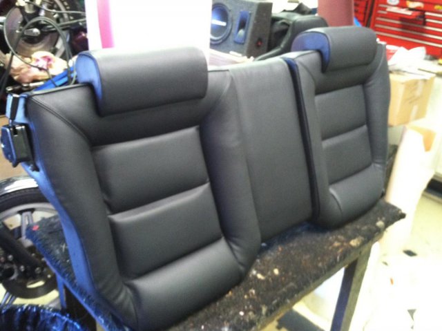

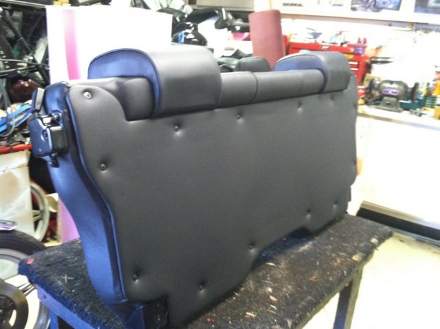

  21. Mdantonio
    260 2+2 seats
    Opz...or is it PI? Lol Tony, I included some pics of the back of the seat, a simple glassed panel to match the front as I don't plan on turning the back seats down....thanks for the compliment!
