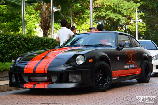

Anyone know what front air dam this is?
invalidusername replied to invalidusername's topic in S130 Series - 280ZX
Awesome, thanks man. -
Sorry, just found this picture tonight, I really like it...I think. just seeing if anyone knows who makes it.
