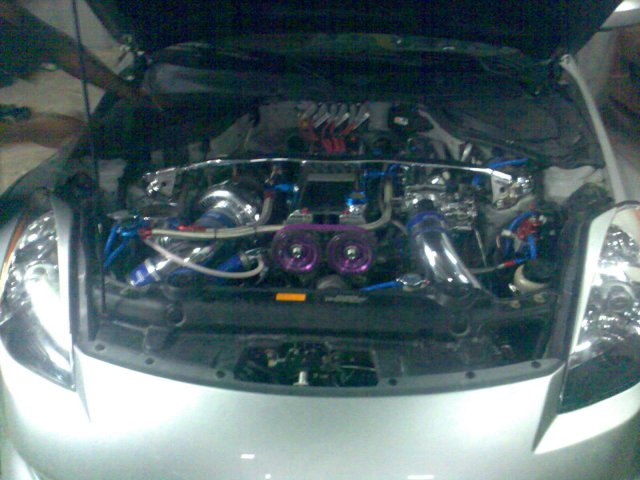

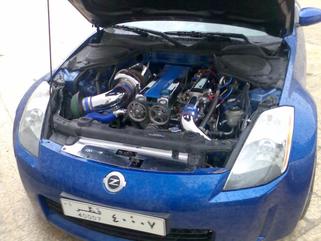

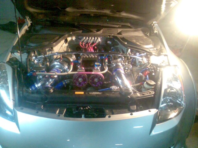

  1. Check these pics : 350zs hybrid with 2jz gte blue one fully built t88 1700cc injectors,motec 950WHP. without nos. the gray one upper built with t88, 1200cc,motec. 743WHP without nos.

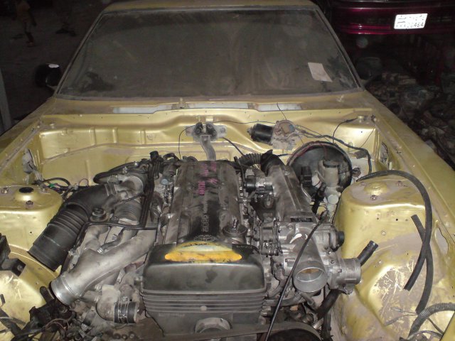

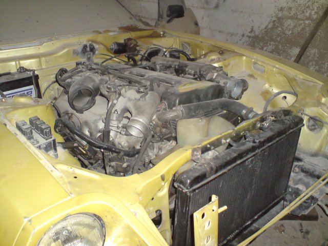

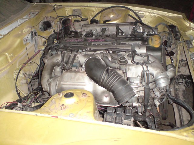

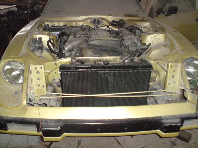

  2. I have tried to mount the engine backward but the problem with power steering. It touch engine pan oil, therefore, then I changed oil pan position to be in front. The result, as seen from pics, the engine is way forward which will not be accepted by police traffic register office:icon_frow. I am thinking to replace power steering with 260xz power steering, to be in front, far from oil pan. Any suggestions I appreciate.
  3. These are the pics of my progress so for.

  5. Hi how you modified the original engine chair to fix 1jz in this position. Because i have problem with fixing 2jz in my 280zx.The original oil pan of 2jz hit power staring. So I had changed the oil pan to be in front and removed stability bar but the radiator did not fit inside bay thefore i fixed it front, outside bay. the current problem i face now is, hood is not closed because the engine is higher than the level of hood?? Any help. Thanks
