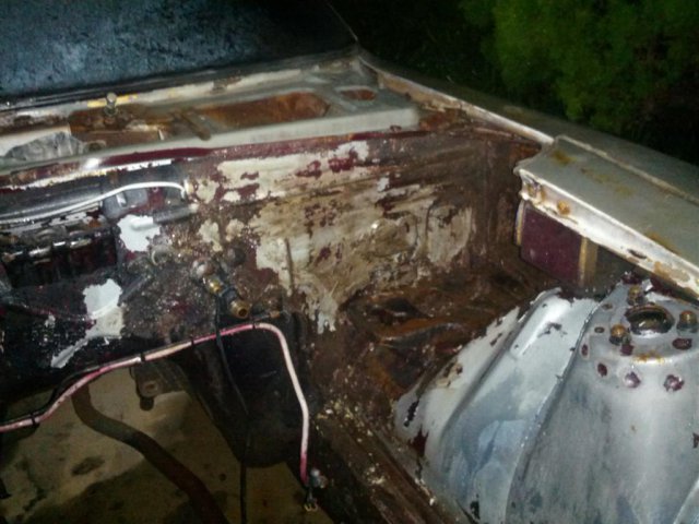

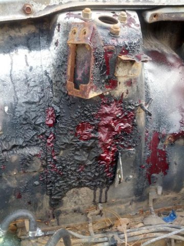

  1. the stripping fase is nearly half way done on the body.

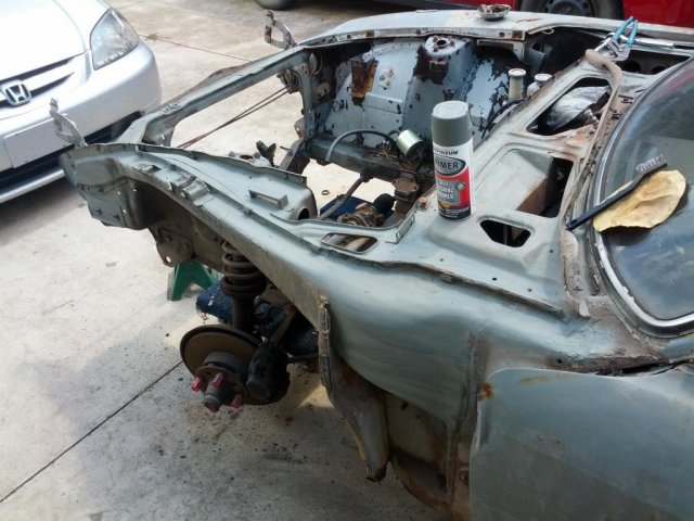

  2. Overspray isnt a problem, ill be spraying most of the primer in the driveway, then carry it to a booth to handle the base/clear.... been there, done that too many times. from what i have read, epoxy binds best to metal substrate, but they list nothing else. i have heard of evercoat, and i have a gallon of bondo sitting in my garage now thats actually bondo brand. i thought the same thing, then, i read about how body fillers of different brands actually have issues with creating a rust inhibiting situation. but that w2as geared towards specific brands if i remember correctly. Specific product lines always help, as well as reinforcing the products that have been used and proven. thanks!

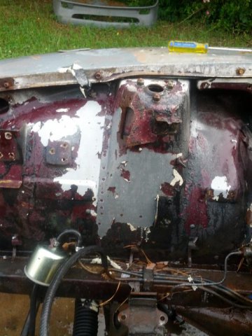

  3. I have a 75, with a good amount of rust being cut out, weld, grind, lather, rinse, repeat as necessary. i want to seal the body up, as its sitting in my driveway and surface rust is a big issue. i have a few coats of primer on the surfaces that i have stripped completely, but i am looking to Epoxy prime the entire bodyline. the underside will receive por15 with undercoating. now, do you prefer or have experience bondoing before or after the epoxy coat. The only thing that worries me about spreading putty after is the possibility of breaking through the epoxy coat, and loosing that protection. My process as follows, Flapdisc strip - reason being i have three coats of paint and body work to cut through aerosol prime to protect from elements Sheetmetal bodywork with no bondo Airfile smooth - and epoxycoat within 24 hours Bondo filler to the absolute minimum huigh build primer. thoughts?

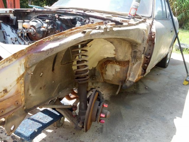

  4. bit busy, did some stripping and priming to temporarily seal. have a few broken bolts to say the least. and a few more that need finessing. a bunch
  5. its sooooooo slow. im ready to work on it some more, and drive it above all.

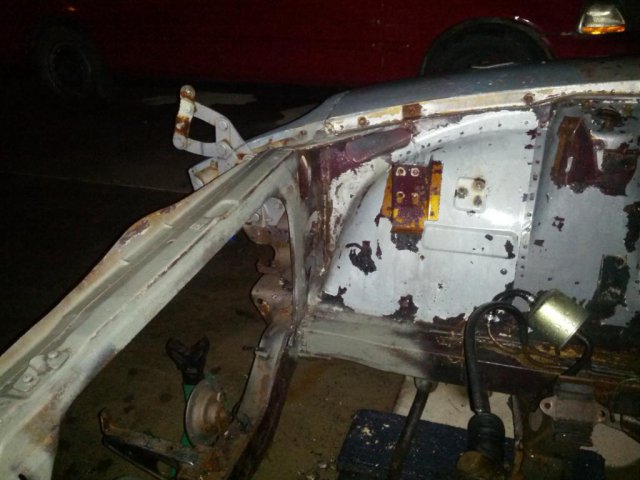

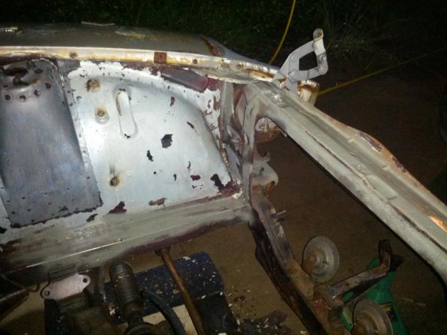

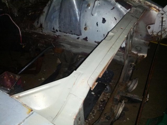

  6. Stripping the bay.. Tig it up, paint it pretty
  7. Pulled the front part of the wiring Worked through the 21circut painless wiring kit Looked at dash wiring a bit Gearing up to replace the floor pans Stringing it out a bit. Looking through suspension now, even though I still have no clue.

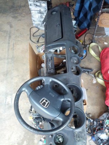

  10. the car has sat, got the dash out, pulled most of the engine bay harness.

  12. This guy is getting a fun fast track. nothing fancy other than the looks of the bay. some mods, and an RB20 maybe 25. painless wiring. ripping the old out as we speak. dash is out, to examine the even more places we have rust, but still wanting to drive.
