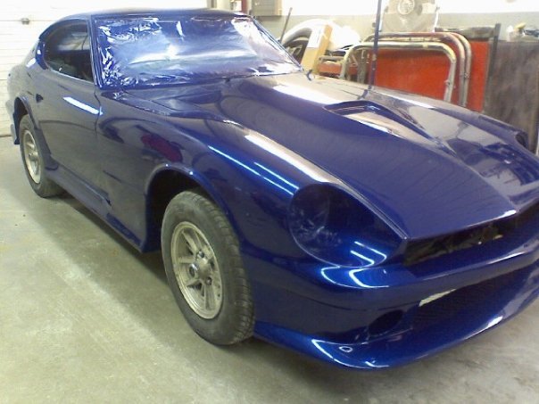

	As stated before, when we were looking to buy the Z in the first place it was between 1 on ebay and 1 on craigslist. My dad didn't want to put too much into it so he drove down to Conn. one day and just bought the Z off craigslist without really looking at it too in depth or anything. So yeah there was a lot of rust, it wasn't really THAT much, but more than we could handle so my dad decided to have a body shop do it, and repaint it also. Well, the quote was for $3k and 6 weeks, 17 months later we got the bill, a whopping $11k. At the time I didn't just have that kind of cash to dish out so I sold my only operating car, a Jeep, to pay for the body work. So up to this point I've put in about $6.5k, including other odds and ends like the body kit my dad wanted for it and replacement struts and bushings. After we got the car back we didn't spend a lot of money on it because 1. we didn't have much to spend, and 2. we were busy replacing bushings, and obviously some bushings are a pain in the ass to remove and frustration arose and thus breaking misc. parts trying to get stuff apart. Another couple hundred bucks later those pieces are replaced, and then my dad hands me an invoice for full interior vinyl replacement, another couple hundred bucks. So here we are about a year ago, car is starting up and engine revs happily, suspension almost completely done, but the brakes are messed up so my dad tells me he found a "deal" for stock replacement brakes, all 4 corners for like $975 or something, and I said if we're going to spend that much money, we're going to get better brakes. So we bought the gt500 big brake kit (~$1400 i think) from a member on here. So there's $8k right there, then obviously needed bigger wheels and tires to fit the brakes, now we're up to $9k+ on my end since my dad refused to pay for any "performance parts" so yeah closer to 10k on my end so far, and the car still isn't drivable, nor able to pass inspection. I don't know how to multiquote replies, but @garvice: I'm thinking of just trying to recuperate the last couple grand I spent on it, (wheels, tires, brakes, and some mechanical work) and then I'm going for a sweet e30. If not, I'll keep the Z and eventually get it on the road, but I definitely need a break from this project. The main thing that I've learned is if you are going to do a project of this magnitude, drive it around stock to get a feel for it, then upgrade minor things as you go (struts, bushings, exhaust, etc.) and see how it affects the ride and whether or not you like the change. This way you can actually enjoy the car and the fruits of your labor as you go. Anyways, attached is a picture from about 2 years ago? I don't remember anymore, it's at the body shop after getting painted. It looks even better now with the new wheels and the monster brake kit on it. Damn it guys you're making it so hard to want to leave this car behind.
