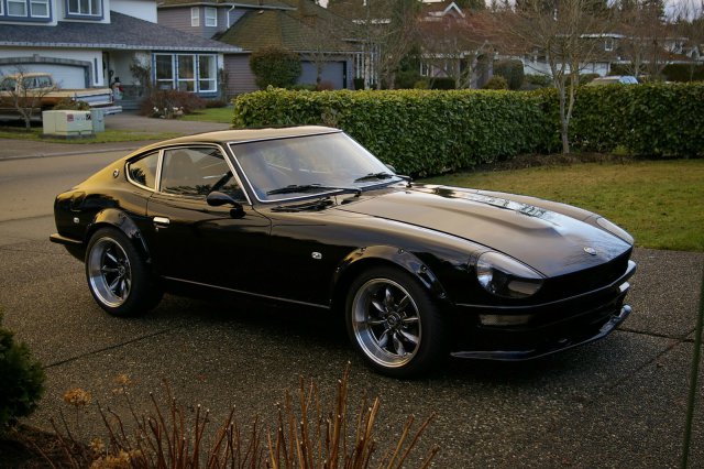

  3. Hi ! Thanks for your reply - I have now found a viable way of contacting him, even though i know that he no longer owns the car. Yes...its a beauty, and Im wanting to base my car around the way that his car looks....Just love the Dish on the wheels, and the way it sits ! Thanks so much for your help ! Woza

  5. Mods Please move if this Post is in the wrong spot - I wasn't sure where to place it ! OK, I have had my 260Z for a long time, and After finding this picture, I have decided that its the right wheel/Flares selection for me. I would LOVE to get in contact with the owner, or if its been on-sold, the original builder, to get the EXACT specs of the wheels & Tyres & Flares. Yes, i know that there will are plenty of wheels out there similar, but for me, these ones look Spot on the way they sit on the car. So, that information would be invaluable for me ! So, Please guys and Gals - Anybody who knows, or might know anything, please reply to me - I would very much appreciate it ! Cheers in Advance ! Woza !
