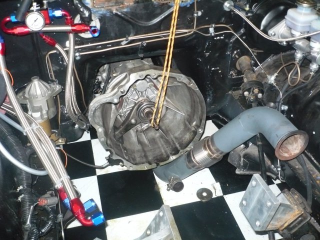

  5. It was on and off for a while, at one point I was ready to sell it, but finally pushed through and got her running. Here are some pictures

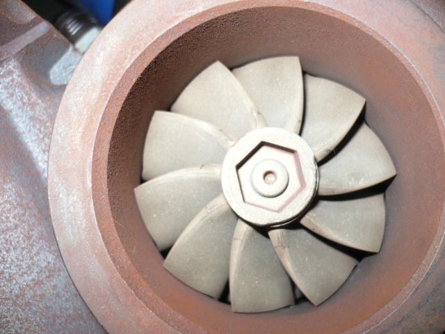

  11. Looked at the turbo closely and found this. Blade tips broken on the Turbos(GT4088R) exhaust side. The turbo is brand new, only ran 30 minutes on the Dyno, no more than 5.5-6k rpm. Any input would be appreciated. I would like to figure out why the tips broke and ended up in the piston tops and the quench pad area, before fixing the turbos.

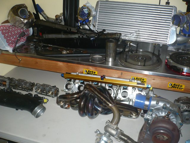

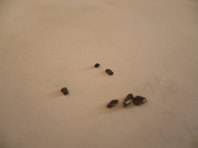

  14. Upon further inspection and clean up, I got some samples of the pieces on the pistons and the head. (1st photo) They are aluminum, and looks like they are pieces of the head/quench area, and the pistons. Here are some photos of parts taken off, (to go back on, soon, hopefully).
