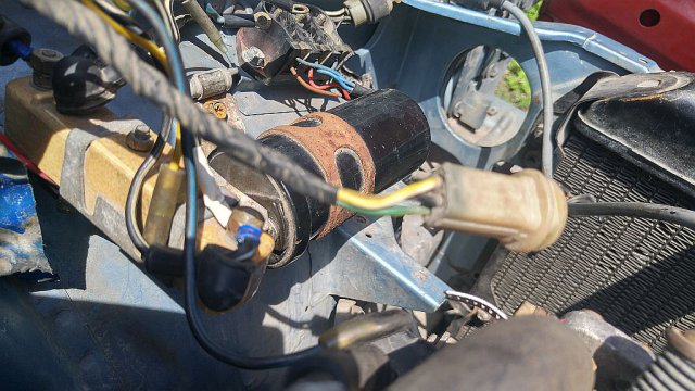

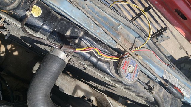

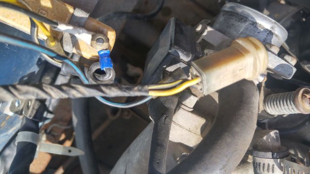

  5. That plug doesn't have any blue. It'd black/yellow, green/yellow, and white/yellow. The blue wire you see is coming off another part of the harness. I will snap better pics later today to be more clear. As for the FSM, I've read over and over for this type of plug with the wires, didn't see anything... Unless I'm just blind?

  7. Edited with pics of the one plug for now. Thanks!
  8. So I acquired a 76 280z with the stock drive train. It was missing the fuel injection system (Intake Manifold, MAF, and etc). I bought a donor motor/trans, that came with full harness, maf, ignition coil, transistor module, and basically everything I needed. Got most of everything installed but having some issues with some wire/plug identification. I've searched and looked at so many damn wire diagrams and for the life of me I can't figure out which plug/wires these are. So any help would be greatly appreciated! The stock drive train won't be in for long, but I'd surely like to get it back on the road running on its own power! Edit: won't let me upload pic from mobile. Will post pic from laptop when I get to the house. But the plug is a 3 prong (green/yellow, yellow/white, and black and yellow. The connector it was to had 3 wires also (yellow, white, and red; this wire had a bullet point connector on it) Edit: pics!
