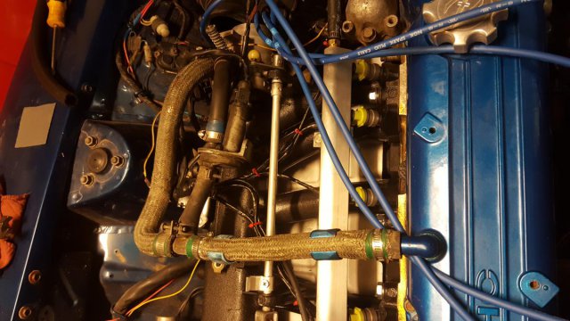

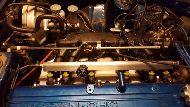

Alright guys, I have a 1976 280z with a l28. Mostly stock other than a stage 1 cam. Ran just fine before I messed with the fuel system. I went with the pallnet fuel rail, Toyota cressida injectors, new injector clips, and deleted most of the vaccum lines. I rewired the injector clips, solder and heatshrink tubing. Installed the fuel rail and injectors. The fuel rail is getting pressure, the guage reads about 35psi. I'm getting spark, replaced plugs and took one out and connected to wire while cranking and sparked fine. Won't even try to start, even with starting fluid sprayed in the intake I don't even get a hiccup. On another note my positive cable gets hot when cranking? I'm guessing just because it's using so many amps. Please someone help!
I have a question for anyone with the pallnet fuel rail. I ordered mine a couple weeks ago, fitment is perfect. I ordered the 11mm rail and I also had ordered some denso cressida injectors. I had to change the injectoright clips for them to work, so all the clips were replaced and wires soldered together. I have everything together and I'm not getting any pressure to the rail. I have fuel, but no pressure. Has anyone else had this problem and a solution? I included a picture of my setup. Thank you.
