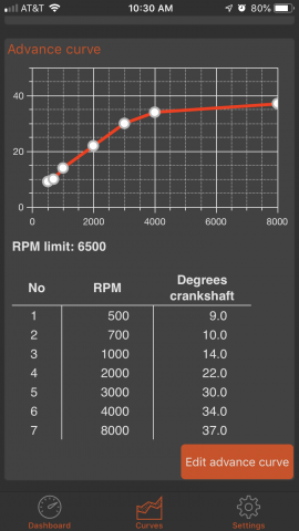

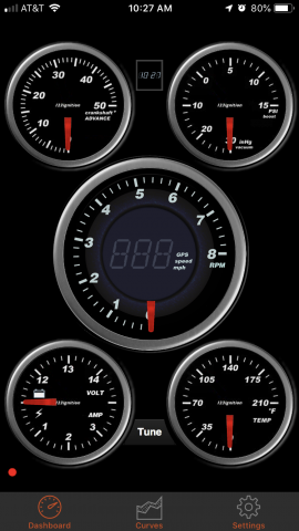

You can buy a Bluetooth dizzy from 123ignition and run an app called 123/Tune+ that lets you set advance curves and vacuum advance. You can tune advance +/- “on the fly” and also has gauges on your phone showing: accurate rpm, advance, vacuum map, voltage, gps based mph and dizzy (so engine compartment ) temp. You can set a max rpm, which is random spark cyl suppress enforced. It can also do an ‘immobilize’ with pin code. I previously used a ‘kill switch’ with my stock dizzy for this A nice bit of kit for the L6 engine. My 240z (2.6L, N42 rebuilt head, SUs, header, NA) runs better than it used to.

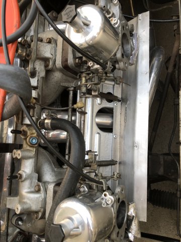

I have a 240z with rebuilt E88 head, rebuilt dome top su carbs and I just went from stock manifold with 2.5” exhaust pipe and cherry bomb muffler to a header. I kept the pipe and muffler as the weren’t stock anyway, I just added a flexible connection from the collector to the existing exhaust pipe. Actually now I wish I didn’t do this modification. It’s really noisy and I’m not sure that moving away from the OEM cast iron exhaust manifold was a good idea. It seemed to do the job... any comment on the performance improvements or lack there of? One other point - within 6 months I had a fuel leak right over the header pipes even with all new fuel lines. It totally cooked the new fuel lines from the float bowls to the jets. They were cracking and perished. Dangerous. I have since replaced the SU carb fuel lines with correct parts, and modified the heat shield with an additional aluminum plate which sits under the fuel hoses/jets. I also added some heat wrapping to the fuel lines. Makes tuning more of a chore, but gives me peace of mind. Anyone have a solution to the header noise issue? Add a resonator? Change the muffler to a better one? I can tig/mig weld so would buy parts online and do the install myself. I’m not a boy racer (nearly 60) and it sounds like an F1 car now when I put my foot down. Yeah, I know- some of you would think that was a ‘bonus’. Richard

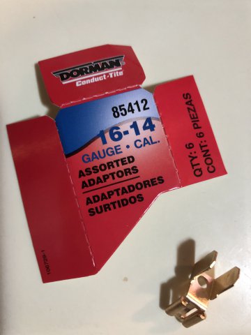

I know that this is an old thread. But I had the same problem and knew it wasn’t the starter or solenoid as I had replaced them recently and the old one tested good Cleaned up the ground wire connection to the fender wall opposite the starter solenoid. This was rusty on my car- I cleaned the ring terminal, the lock-washer (do any other washer) and the bolt threads with a wire brush. Then I cleaned the spade terminals to the solenoid and replaced the brass T-connector that hooks both female connections to the male terminal on the solenoid. Re-terminate them if they are loose or beyond hope. Problem is gone for a $2 part. Doorman 85412. Use the part pictured or the one that matches what’s on you solenoid. If it isn’t your starter and isn’t your solenoid, then do this first. I was chasing around looking for other wiring problems and should have checked these connections. I suspect adding the direct ‘relay’ is sometimes just cleaning up this connection, when other loom problems from the ignition key switch aren’t to blame.
