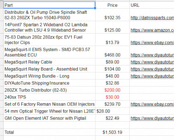

So I've gotten sick of attempting to fix this botched wiring job by the PO. I decided to just go ahead and completely replace the ancient efi system with something modern. I was wondering if this parts list looks complete. From scrounging various boards and posts I think I've gathered just about everything I will need. I'm a little intimidated by the whole thing so sureing this up will make me feel just a bit better.
