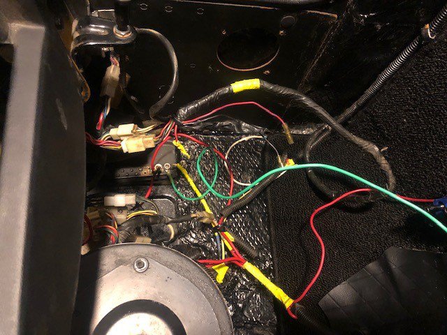

Thanks for the warning!!! I ended up just connecting a hose as a temporary use for testing engine start. i ordered a Vincos 20ft 6an an6 nylon and SS Braided lines. So now that the gas has stopped leaking, the issue still stands. But first l want to make sure the car is safe. The pic is not great but the fuel pump is right by the tank. The fuel pump was then sliced into two? And one just isn’t used and the other goes to the oil sender switch and then an output? from the sender to the relay I set up temporarily. I hope the pictures are clear

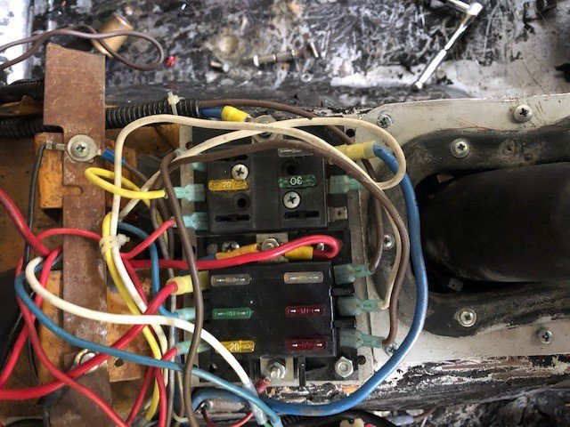

Hello i have a sbc in my z. My wires fried (literally) so I am in the process of re wiring using the painless 21 circuit. I pulled out all of the original burned harnesses and starting from scratch. Im sure I got some wires crossed but my main concern is relays and the voltage regulator. 1) Do I need to add any relays or is it just an extra precaution. If I do where would I place them in the wiring. 2) do I need to wire up the voltage regulator ( by the driver side kick mat). If so, what wires do I use 3) for the rear brakes where does the third brake light wire go. All other connections seems connected

My Painful wiring should be coming in tomorrow. I wish i could figure this out but electric is my achilles heel. not sure what pics of the engine wiring you want to see but maybe this will shed some light IMG_1100.HEIC IMG_1506.HEIC IMG_7128.HEIC
Yes...the fuses short as soon as i connect the battery. The blown fuses are usually one of the 4 wires attached to the relay. Ive been asking around for any shop that can do this but unfortunately no can or wants to. Worse case....ill install the Painful painless wires ...hopefully i can find the short(s). I check the grounds. Question......Are wires still good if the cover is intact but the actual copper inside looks burned...or do they need to be replaced? I know the connection is there but does the burn cause less connectivity thus causing potential issues? thanks again

Thanks for the support. The car has a SBC and a T56 tranny. Im not sure how the PO did the wiring but it was a mess and sloppy which is why it burned. Does that make any difference? I almost feel like i have most of the wiring connected based on the harness connectors, but i have not idea what goes to the aftermarket fuse box and there is also a resistor. I have a 2/71 240z and bought a used harness from an older 71 based on the differences. I have the FSM but not sure if it would apply to the engine. None of my dash gauges are coming on or powering up. Is there a specific line i need to connect to power the dash? My headlight works, the flashers work and the key clicks when i turn it...however thats it. everytime i put the battery cable on , a fuse blows and its usually connected to the resistor. I dont even know what the amps should be on each changed the starter but its still the same, the battery is new. Any help is GREATLY appreciated, or if you can recommend someone that can fix it at my house...im in Northern NJ right by the NY Border.
