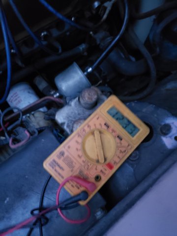

Tightened the intake manifold, engine starts for a sec on starter fluid. I'ved narrowed it down to the injectors. Per FSM, I checked the pinout for each injector on the ECU Harness and all have 12+ VDC. Checking the injector harnesses directly however yield a different outcome. I'm unfamiliar with how to check the injector harness so I unplugged 3 harnesses and checked Ohms first by touching the left pin with one point and right with the other, all 3 that I tested gave same result of 0. When I checked VDC by hot point to a pin and ground point to a ground, each outcome was different for the 3. I've included two images showing what's up. I may have to just go Megasquirt if it gets too complicated haha

Hi, I have a 78 s30. Been working on the car recently and noticed the alternator isn't charging the battery, and the red charge light is on w/ the voltage reading about 6 on the stock gauge. When the car is running w/ no accessories on, voltage of the battery is at around 12.2-12.35v. Read through the electrical section of the FSM. With the car running, POS point on tester to battery, and NEG point of tester to the point on the alternator that says BAT, the tester reads 10.35??? This doesn't seem right, A pos and a pos shouldn't read a voltage like that, right? Think the alternator could be grounded out somewhere in the 40+ year old wiring? This alternator is 10 months old.
