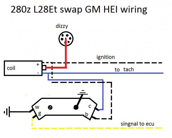

  18. Nope, then I tried the 1980 zx distributor with e12-80 module, no spark. So I'm still stuck in the water. I'd like to get this e12-80 setup to work but no dice.
  19. My apologies, the readings I recorded were taken when the key was in the on position. I just recharged the battery and the reading were about the same, the battery's voltage is around 12.70, while B is 11.70ish and C is 11.34. I'm positive I followed the diagram correctly as well as grounding the module properly, do you think I could've blown the module somehow?
  20. B - 11.79volts C - 10.52volts W - 5.89volts G - 5.89volts Hmm, think maybe the ground isn't good enough? Also when the key is in the on position, I hear a faint whining sound coming from the HEI module. Thanks again for the help!
  21. I haven't troubleshooted any of that, I'll definitely do that tomorrow. Thanks so much. Also I've seen two different diagrams. The one I posted earlier and this one. Not sure which one is correct one for me follow, using a stock 1978 with L28e, harness and everything.

  23. Thanks for responding guys. I have the module bolted down to the chassis via the mounting holes. I'll take pictures soon to show how my setup is. I followed the tutorial created by another user and still not getting any spark.
