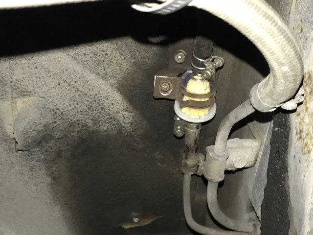

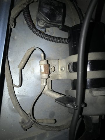

  5. what is this filter for? it doesnt look oem.. also this is the condenser correct? where is it supposed to be connected to?
