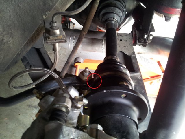

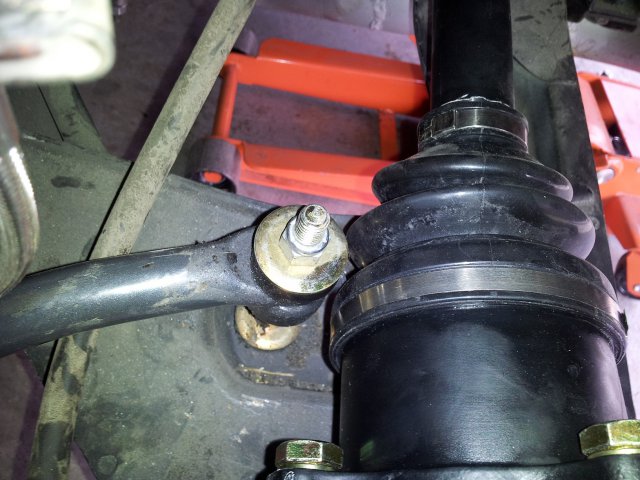

After shortening my swaybar end links by about 3/4 an inch, I have almost an inch of clearance at ride height, and it is _barely_ touching at full droop. As long as I don't try to rotate the wheels while its up on a lift I should be fine, right? -

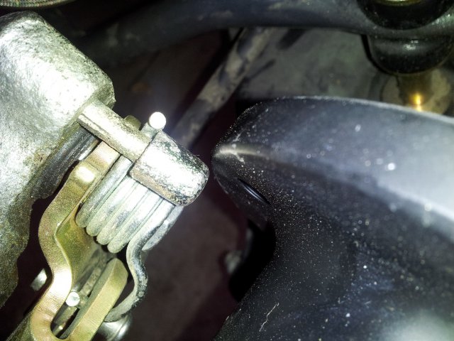

I have about 1/4" of clearance on drivers side through my entire suspension travel, but it's touching on the passanger side just barely. The actual swaybar is touching, not the link, so I think if I grind down the corner of the swaybar a little bit I will have enough clearnace. Getting a shorter end link may help too, I might do that instead... -

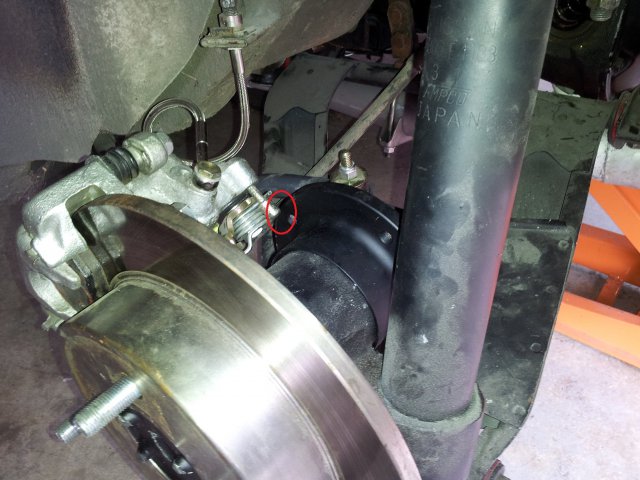

Finally got the Z31 CV and 280z stubs on. It was a SUPER tight fit between the adapter flange and disc brake caliper, and CV axle and rear sway bar, but it appears that it will work! Thanks again to JMortensen for all his help! -
