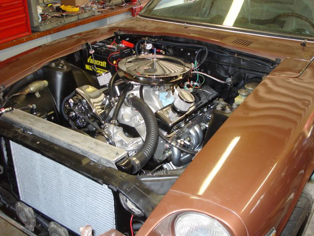

Looking good! I have a normal-mount alternator with an electric fan. How well is your pulley system aligned? It seems to me that the crank pulley is about <1/4" out of alignment from the water and alternator. I couldn't ever find the proper shims to fix it, but since the crank is fairly far away, I thought it would be ok.
