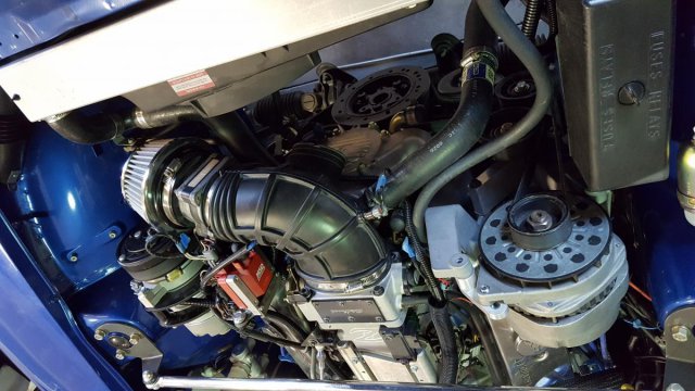

Well, it has been quite some time since I started this project. Still not done, but the good news is I have the car running. I mounted the PCM under the passenger seat, which required a lot of soldering to "stretch" the wiring. The interior work is done. Seats, door panels, tranny tunnel, headliner and rear strut mounts have been done in leather. Added a power window kit from MS ACCESS. I'll post more photos later, having trouble uploading from my phone. -

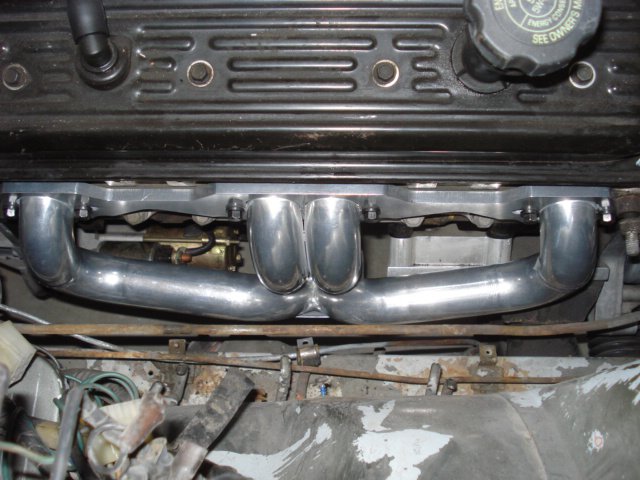

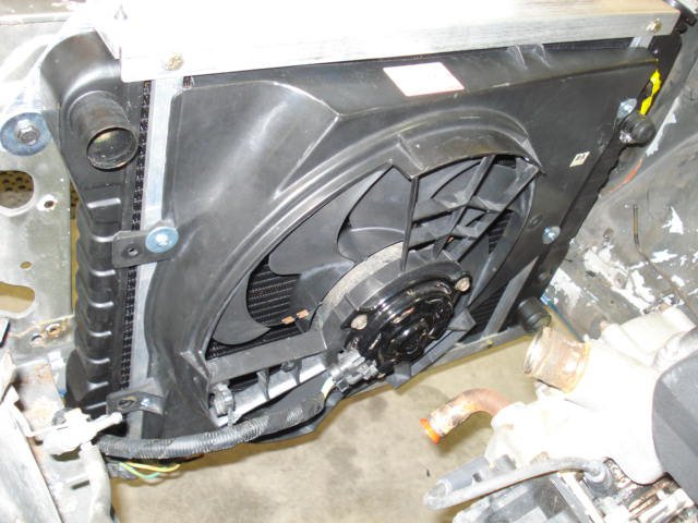

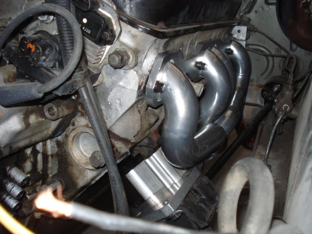

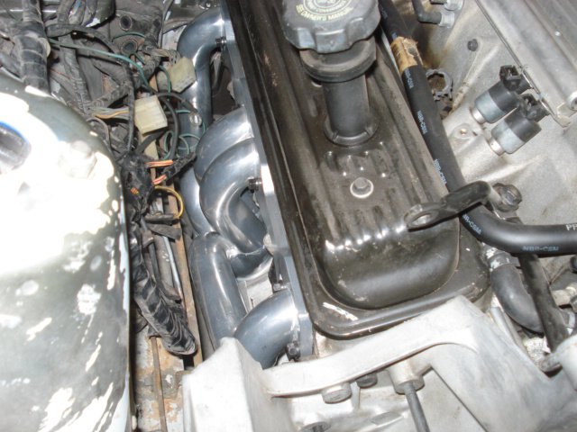

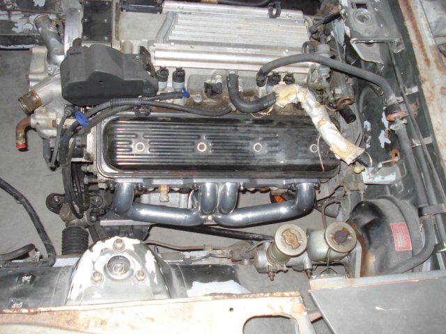

I dropped my '73 Z off tonight to have the exhaust built this weekend. I'll be going over the details with the guy doing the work tomorrow night. He runs his shop out of his garage. The LT-1 is in there with JTR mounts. The headers fit without any trouble. I also have the JTR radiator mount kit with a Chevy radiator and an electric fan I pickup up out of a 90's Mercury at the salvage yard. The drive shaft from the donor car ('95 Firebird) is at Northern Colorado Driveline in Greeley, CO to be shortened and balanced. They are also going to replace the rear yoke so that a standard u-joint can be used with the JTR mounting flange. I replaced the R180 with a 3.9 R200 and RT mount. The tranny is a T-56. Next up is plumbing the fuel lines and a small fuel reservoir. Then wire up the PCM and hope it starts...

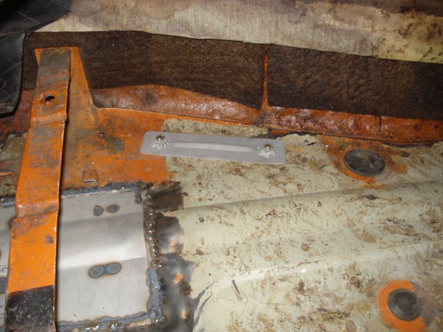

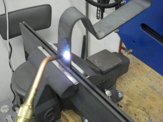

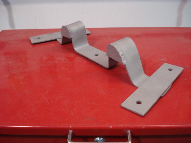

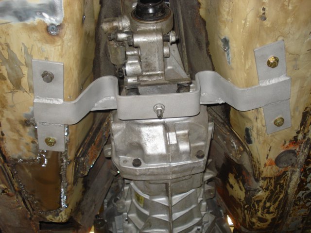

Here are a couple of shots of a T-56 cross member I made for my '73 240Z LT-1/T-56 swap. I used 2" X 1/4" bar stock. I heated the bar stock with an oxy-acetylene torch to make the bends. I welded a couple of nuts to some 18 guage metal and ran the mounting bolts up through the floor. These will ultimately be tack welded to the floor after I finish up patching the holes in the floor...

Ok, I have only been able to squeeze in an hour here and there, but I finally got the engine and transmission mounted in the car. The JTR mounts are in place for the engine and the tranny is currently held in place with a lug nut wrench (X shape) and a chain. I made a cardboard template for the tranny crossmember, similar to one I saw here on the site. We shall see if my welding skilz are up to the task of fabricating it, otherwise I'll take the template to a machine shop and have one made. I have a R/T diffy mount that is ready to go in once I remove the exhaust hanger bracket that is in the way. I don't have a drill that will fit into the tranny tunnel so I can't drill out the spot welds. Harbor Freight, here I come, I need a cheep right angle drill! Once I get the tranny crossmember installed I'll take the car to a drive line shop to have the drive shaft shortened and the drive line angles checked. The next stop will be a muffler shop to get the exhaust system built and installed. I've got a pair of the Sanderson "D" port headers from JTR that I still need to test fit. Based on the experience of others, these should do the trick. I picked up a Wilwood small clutch master cylinder from an outfit called Speedway Motors (http://www.speedwaymotors.com/Wilwood-Clutch-and-Small-Brake-Master-Cylinder,8567.html). I also picked up an adapter that will mount in the stock T56 slave cylinder and allow an AN3 fitting to be used. The clutch plumbing should be easy. I'll post pics after I get it plumbed. I bought a radiator locally that should be the same as the one offered by JTR. It fit perfectly in the JTR radiator mount. I haven't got the radiator hoses yet, although I've got a few ideas on how to cut & plumb them. I picked up a 2-speed electric fan at a salvage yard from a '90's Merc (can't recall the specific model). It fit perfectly in the JTR mount. I drilled & tapped 2 mounting holes on each side of the aluminum uprights to mount the fan. Here are a few shots of the recent progress. -

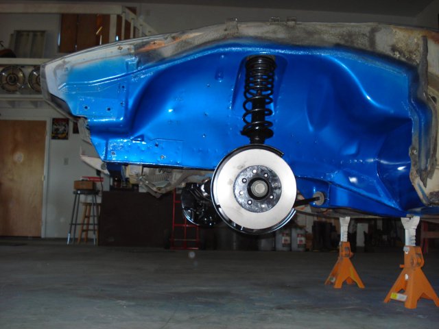

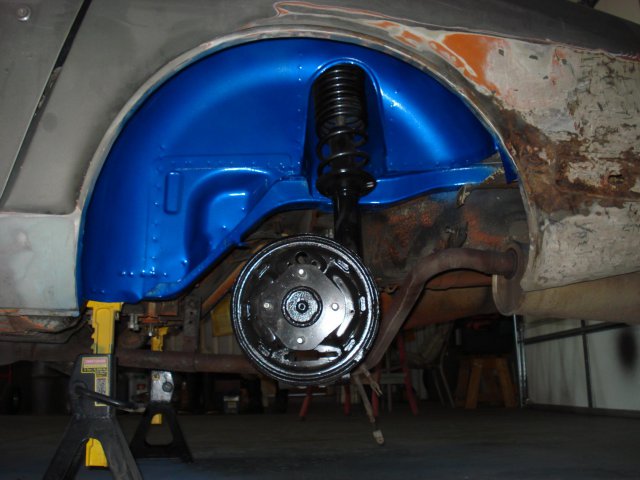

I sprayed the wheel wells with a Cobalt Blue single stage paint from PPG. Man, that was a messy job, getting the wheel wells cleaned up. I started with a heat gun & scraper to remove most of the undercoating that was there. Then I used laquer thinner & a Scotchbrite pad. The going was slow so I broke down and used a sand blaster. Even with plastic sheeting put up I still am finding abrasive everywhere in the shop! I haven't done much with the actual underbody yet, as I have a few holes to patch. I'm planning to use a pair of seats I picked up at the salvage yard and will probably need to make changes to the seat mounts in the car. And I don't know if I'll need to make any changes to the tranny tunnel for the T56 yet. Once I get things sorted out I'll spray a little rubberized undercoating on the belly. The information on this site has been extremely helpful so far. Without this site I wouldn't have known about the A/C relo kit or the power steering delete pulley kit. And it is great to see the V8 swaps that others have done. It took me awhile to decide which way to go: carbureted or fuel injected. I'm an old skool kinda guy and dig the sound of a 4bbl when the secondaries open up and start sucking a lot of air! Ultimately I decided to go with a more modern approach with the LT1. I'm also a closet techno geek, so the thought of tuning the PCM and making small, modern upgrades to the car holds great appeal for me. -

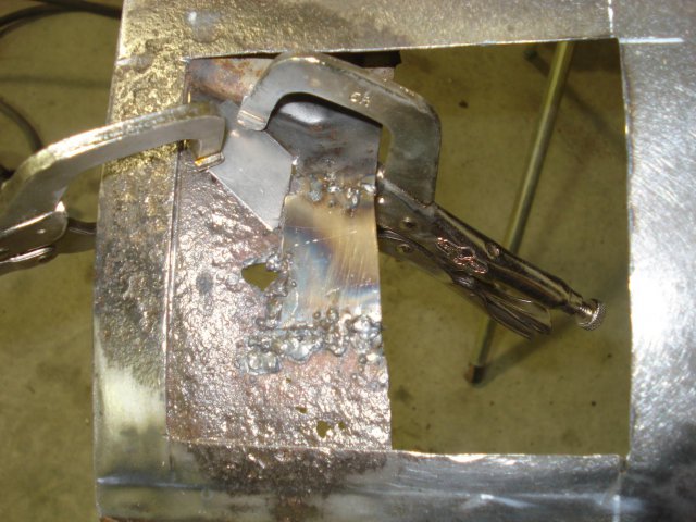

The hood turned out to be in real good shape. I found one crack near the left front edge, and 2 dents that had a fair amount of filler along the front edge. I used a stud welder I got at Harbor Freight to weld studs to the dents and pull them out. Not perfect, but each dent will now only require a skim coat of filler. I used the MIG to fix the crack. -

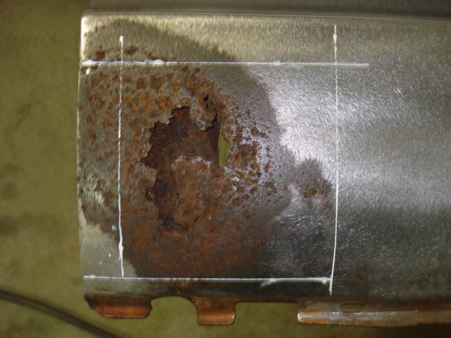

The fenders were rusted through in the usual spot. A little work with the MIG fixed them right up. I used USC Duraglass to coat the repaired section, then shot the fender with PPG 182 high build primer. Evercoat glazing putty was then used to skim coat the low spots. More high build primer, lots of sanding and the fenders are smooth as I can get them. I'll shoot them with PPG epoxy primer, top coat with Cobalt Blue, then a few clear coats. -

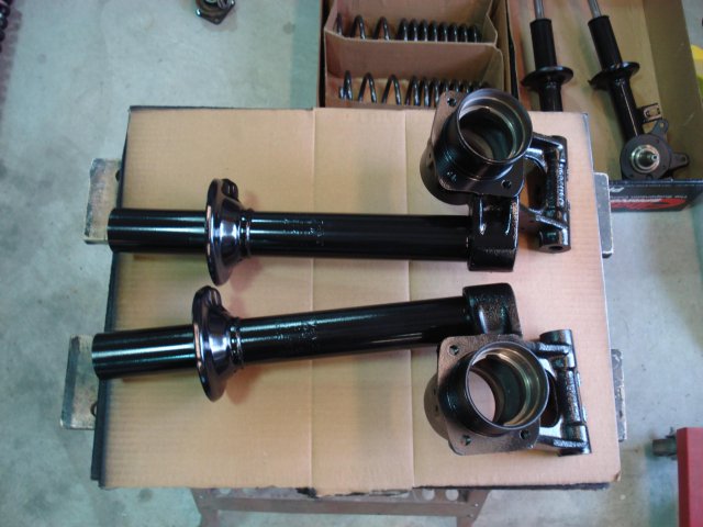

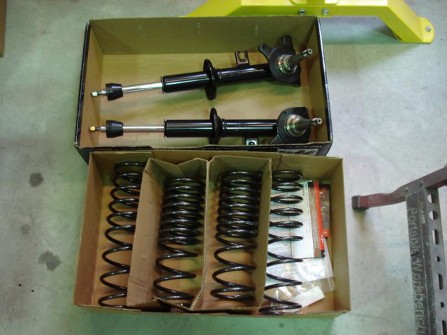

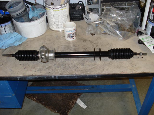

Here are a few shots of the suspension rebuild. I used Eastwood's Rust Encapsulator and Chassis Black to refinish the parts. -
