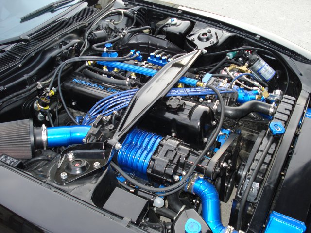

The supercharger in question is a M62 and yes its mounted on the passenger side. There isn't room for AC unless you decide to eliminate the power steering pump altogether. The design does make getting at the spark plugs a bit of a pain however with the bracket/stud design of the SC and intake plenum i can change a set of plugs in under 20 minutes without issue (which is probably better than most new cars - haha). The setup is proving very reliable and i have been road racing the car competetively for 4 years now with next to no issues. The only supercharger related problem i encountered was earlier this year my homemade tensioner pully started to fatique and i started throwing the belt at redline. I fabricated a stronger tensioner pulley setup and have since had no issues. It dynoed at 225hp with 245lb/lbs of torque without any head work and the stock cam. I do have a M90 on the workbench that eventually will get installed with more modified head/cam work once the engine starts to show signs of end of life (which doesn't appear to be happening). The race season is now over here so its time to park the Zed (as we call them here in Canada) and time to move onto ice racing.... I've attached a picture from a few years ago of the engine bay showing the SC setup. Cheers, Mike

Thanks for the compliments. No i didn't tilt the engine, but i did have to cut off a mounting bracket that stuck out the side of the supercharger in order to tuck it in closer to the block/head. The SC is a series 2 of any GM 3.8L. Heres a pic of the bracket if that helps anyone: http://img.photobucket.com/albums/v186/280zedx/107-0730_AUT.jpg Hats off to the first Zcar that is twincharged!
Up here in the cold Canada we have all winter to get creative and work on the car. It's nice having the "down time" to screw around in the garage but it's frustrating as hell when you want to test your results. Thats where i am right now. The car was running real smooth with the megasquirt and stock turbo injectors but i was relying on the water/meth injection to keep the wideband levels in the 12 to 1 range (running well over 100% duty cycle). 1 thing led to another...60mm throttle body, 4"x12"x22" intercooler, 2 1/2" piping, oil catch can, 440injectors, FPR, fuel rail, and a total facelift to the intake vacuum lines. It was lots of fabricating but well worth it. You may notice that all the fittings are not automotive, they take a bit more to work with but are at least a tenth the cost (yeah i know i'm not NHRA legal or whatever the class requirement is). The entire upgrade including paint totalled less than a grand, just lots of labour. I'm now ready to eliminate my belt slipping issue which i was experiencing (it would usually slip at 9psi) and will be in the 12-15psi range with a bit of redesigning on the pulley brackets. The car idles fine now with new 440cc settings in MS but will require new tweaking on the high load end scale which i am unable to do when it's -30 outside. Here's some pictures of the adventure so far: A pic from the start of this project (a few years ago) http://img.photobucket.com/albums/v186/280zedx/Jan_2_engine_compartment.jpg Here's where i had it last summer (as well as signature) http://img.photobucket.com/albums/v186/280zedx/P0001470.jpg Here's a couple pics of it now, hybernating, waiting for spring... http://img.photobucket.com/albums/v186/280zedx/280zx.jpg http://img.photobucket.com/albums/v186/280zedx/passengerside-1.jpg http://img.photobucket.com/albums/v186/280zedx/intake2.jpg I'll add an update in a couple of months around April, which is usually when its safe to leave the garage here in Canada... Cheers.
