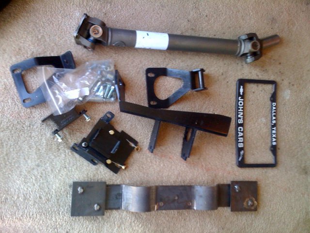

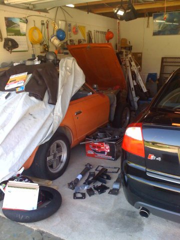

So today I received the JCI kit, and started sanding the engine bay a little to paint it. Here's a few pictures of what is going on so far. I will update more after I finally get it out of the garage and pressure was it.

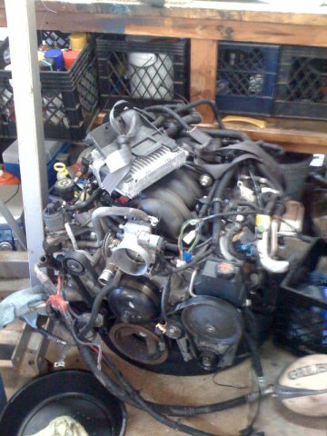

Ok so it has been quite some time with my project and I needed to make some progress or abandon the project. With the help of a member (shout out to Cable) I pulled the trigger and bought a LS1/T56 from a Camaro. Great I have the engine now what? I ordered the JCI engine mount, Trans mount, and drive shaft. So not I have most of the parts including a R200 CLSD that I had laying around. So I'll take a few pictures, sand the engine bay some, prime it, paint it and get all of the pieces that I have together and then, its the suspension.

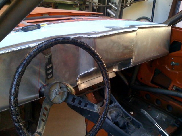

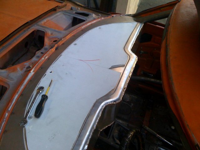

So the dash is in progress right now, I ran over to the shop and was able to take two quick pictures of the dash in its early stages. My plan is to have it coated and a dash cover made, so I won't be blinded by the sun.
Here's the link. http://www.crbalumifab.com/content/20/gallery.html
So I finally I have some pictures to post of my dash, it is in progress, and I didn't go all out, but he is the link to come more work from this shop that is doing the dash.

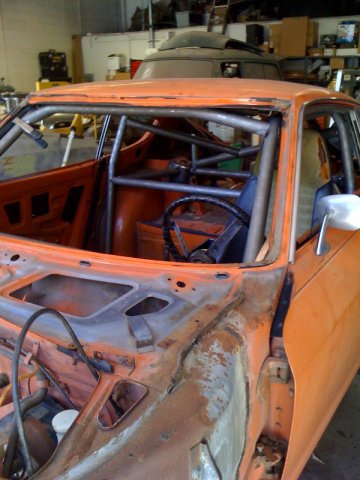

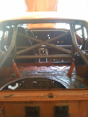

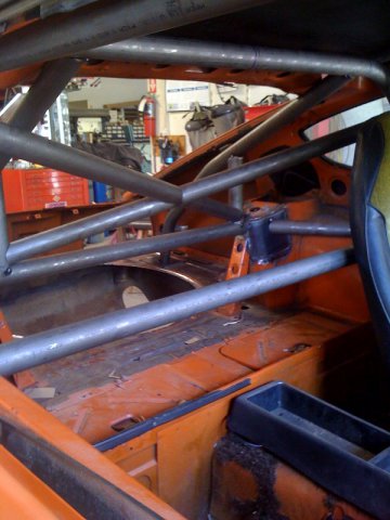

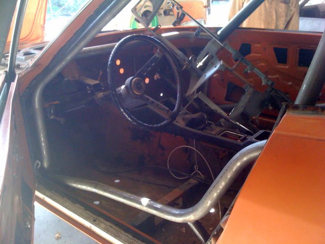

I am starting my Z project for the second time now, the first one I sold to fund this one. I am starting with a 72' 240z, with almost no rust. This car I am trying to build the right way from day one. I have been dreaming of an LS2 with the 6 speed, but have been open to other ideas. Soo.. I got the car stripped for a good price and sent it straight to the race shop in San Marcos, CA. They are putting in a 10pt. cage to support the frame and provide some driver protection in the event I ever take it on the track, yes, it could be considered over kill but I rather over build then to start again. The cage has since been finished and I have a few pictures of it. At the same time I had the shop make me a new fuel tank, that would accommodate the fuel door and still be under the car. Currently the car is in another shop that does custom aluminum and is getting a dash made with center console to match. The door panels were a little beat up and I figured since I have gone this far, I will do the door panels as well. More updates to follow…..
They are supposed to mount the same that the stock styles are mounted, it would be best to cover them but the dash that I am having made will have a coating similar to the one from the stock dash. My goal is new parts with a stock look.
