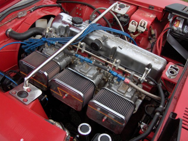

It is a surging idle ONLY when the car is rolling (and not under load) and above 5 or 10 MPH. At a standstill, it is purrrfect! I can definitely hear the LT4 cam I installed. Nice and pleasantly lumpy. That's what leads me to beleive it has something to do with the VSS input into the ECU. It knows for sure how fast (slow) the car is moving. I'm guessing the IAC is affected/controlled somehow by the VSS. I'm almost positive the vacuum lines are tidied up. And yes, the IAC is located just under the throttle body in front of the air intake. Thanks for the compliment on the ride. I know most people don't care for the 2+2's but when you remove the bumpers, they have an eye-catching look. This one is nearly body perfect and VERY rare in Wisconsin as most of them rusted away and broke in half. I wondered at times why I went through the pain and expense of V8-ing a 2+2, but man, I LOVE it!!! The car was my Dad's and has been in the family for 30 years! I'm 42. The attached pic shows what the car looked like for 25 of those 30 years. Of course it was a LOT cleaner. This was a shot I took after I removed it from 10 years of storage.

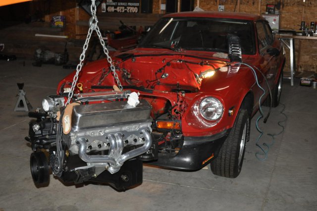

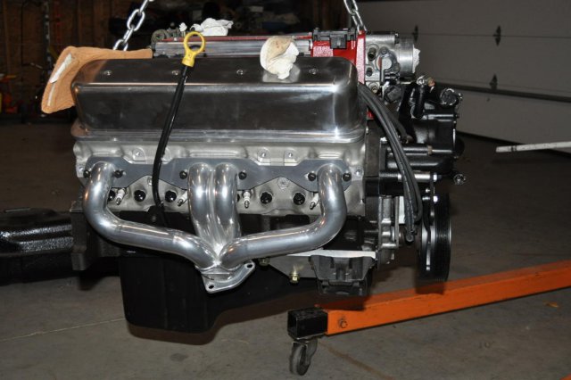

Here are a couple of pics that were taken last nite (late). It is very much a work in progress. I know these exhaust manifolds fit. Also, this is my first attempt at uploading a pic so hoperfully it goes well enough for them to appear.
Looks to me like the exhaust would have to make a 90 degree bend downward and I don't think there is enough space to come off the exhaust manifold and enter the tunnel. Made the same mistake myself with some factory LT1 exhaust. Only they hit the sterring shaft. Had to go with headers from JTR. Just put them in last nite. THEY FIT!!!
