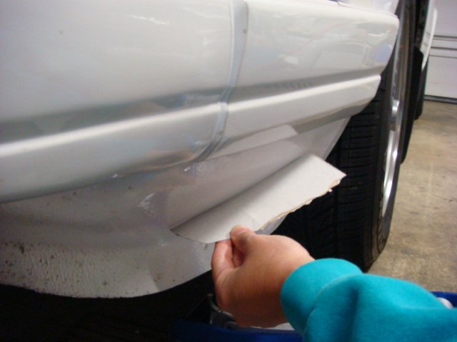

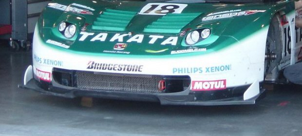

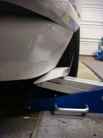

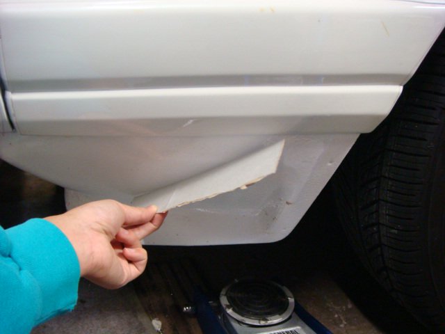

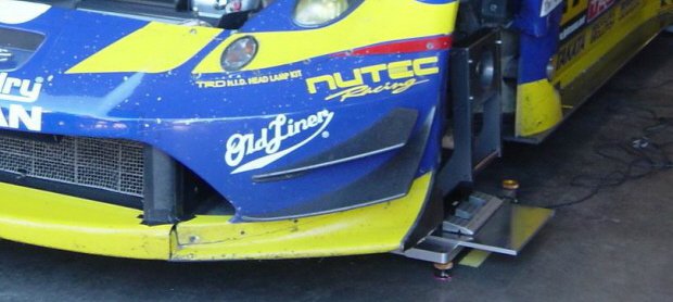

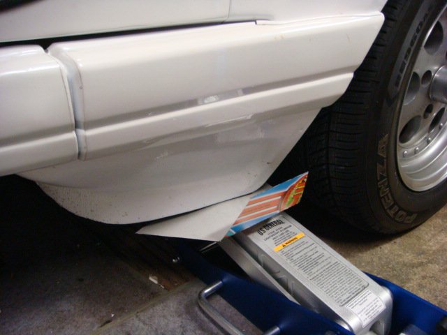

How thick do you reckon I'll need to make the front-wheel-deflectors, in order to stand up to 120mph without permanently bending? Currently, I'm using some ABS pieces in a similar fashion for the rear wheels, as seen in the attached pic. Do you think this will be sufficiently thick/rigid enough for duty on the front wheels? -
For my own reasons, I can/will not further lower or extend the stock airdam on my 280ZX Turbo, but I would like to explore other ways to assist with front downforce (particularly since I have the ZXR wing on the back). The only things I can think of that wouldn't lower or extend the front lip are winglets and canards, which are frequently seen on modern Touring and GT race cars. So I'd like to get some feedback on which might be more effective for the shape of my front airdam, particularly since the factory airdam doesn't entirely block off the front wheels. I'm more concerned with effectiveness than whether or not it looks "right" on an old Z. Of course, if you have other (practical) ideas for increasing high-speed stability that doesn't lower/extend the front lip, I'd love to hear them. For picture ID purposes, the green Takata NSX is to show winglets, while the blue Wedsport Celica is to show canards. And then the following pairs of pictures are for some cardboard mockups of each, just to give an idea of how they would alter my front bumper.
