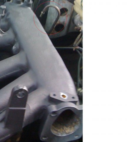

Glad I decided not to shave off all the holes and just fill one with a screw. Easy enough fix. I was hoping you didn't tell me that but guess I am glad I planned ahead. Weird I couldn't find anything that line. Thanks a ton!
Yes it goes down on to the side of the Automatic Transmission. I did not disconnect anything other then EGR and Vacuum on Intake though. I looked through Haynes on the Tranny section no info at all.
Im just about to get my car running again after replacing just about everything. I did removed a lot of vacuum stuff and EGR Delete removed Carbon Canister. But I cannot remember for the life of me what this goes to been a pretty long time it has been sitting lol. Im assuming its like part of the evap for carbons and stuff. I cant find anything though. Any help would be appreciated.
